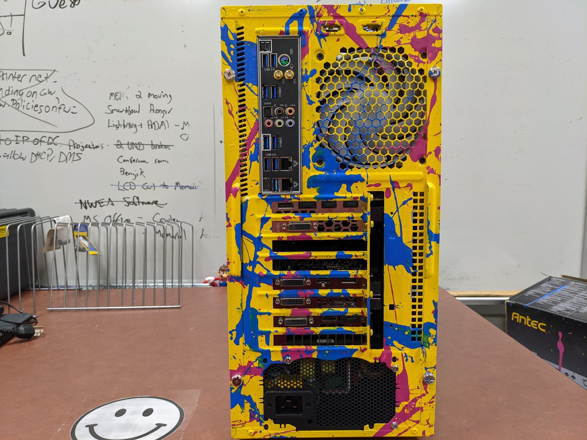

Hello, I am wondering if anyone knows if an ethernet cable head will fit through the rectangle openings at the top of the case, assuming the fan controller/bracket thingy is removed?
I would check on my case, but I completely painted it and those things are stuck in place, so I really dont want to disturb them if it wont fit anyway.

dude come on, its the back of the case, the paint is literally just tossed on it and you can see where shit was stuck to it all over. how often are you looking at the back of the case?! youre missing a pci cover AND the slidey door thing so im guessing not often...

I think thats a good looking case, I spent a decent amount of time on the paint and I can confirm it wasnt "tossed" on, nor has anything been stuck to it. The back of the case is also the part that is seen the most, as this is a reverse airflow setup and I dont like having a bunch of hot air blasted at me, plus without the slidey thingy, I can remove the GPUs easier and it acts as an intake port. Those PCI slots are open because at the time of this pic, my 980ti wasnt ready to go in.

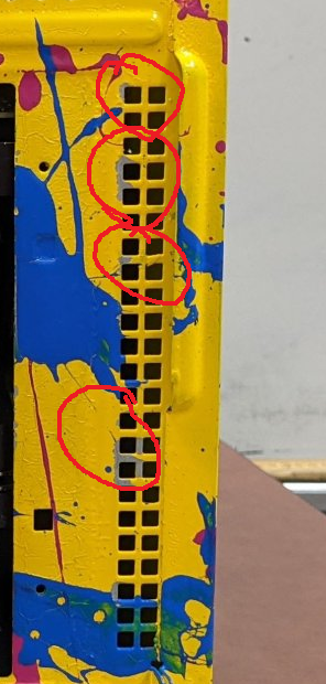

If you do have to do some modding, and don't want to disturb the painted over clips, I'd probably suggest one of the spots here where there is already some paint chipping off. Use some tin snips to remove the corssbars, then file gently for a smooth edge. This should allow you a ;arge enoguh point of entry to pass the cat5/6 cable through and put ends on, if you don't widen it enough to get the plug through entirely.
Thats a really good idea, I might do that instead as it would be much easier to mount a keystone there anyway. Ill have to see how I feel once I get all the stuff together.
