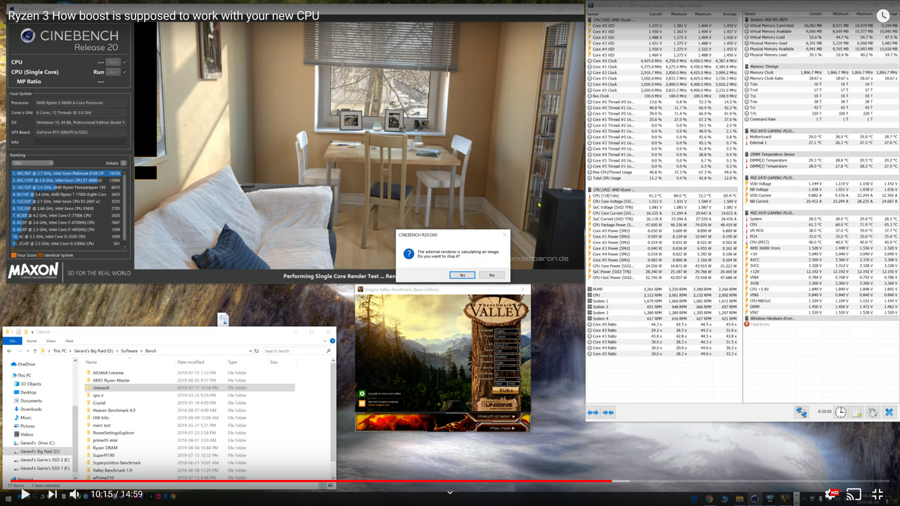

Ryzen 3
How boost is supposed to work with your new CPU
AMD Ryzen processor will increase clock speeds when the CPU has electrical, thermal, and/or utilization headroom to spare. In other words: if the processor’s analysis of its own environment indicates that it can safely go faster… it will!
For those who will not look at video.
Cinebench 20 single run .
All cores hit Max boost on 3600X (4400Mhz Written on The Box)in the run on Cinebench 20 with up to 3CCX(6 cores all running Max boost at same time.)
This CPU Ryzen 3600X has hit 4525Mhz on a couple cores in light gaming load and when cores are not in use they downclock.
Under Heavy load the CPU clocks/Voltage will decrease as much as the CPU needs .
I believe this is how AMD intended the boost to work for all.
Link to screenshot 4K for those who can not see numbers
https://postimg.cc/VSbXGzQx

I will quote myself and I wrote this in the video but I do not talk in video ,just show boring shit.So I do not expect anyone to even look.
Of course the CPU works this way.It is supposed to.
Dan I do not disagree with you on everything.Also in the video I wrote in light loads gaming/idle you can actually see CPU voltage up to 1.57v AMD intended it this way,to give all the juice to some cores to achieve max boost on some/all cores.
If you look at video Cinebench 20,I start cinebench20 then started HWinfo64 to show the CPU voltage in that kind of workload and the voltage will be around 1.5v max .Same behavior you mention in one of the post.
Also CPU of Ryzen 3 xxx are capable of hitting max boost on every core at different times during light load runs like Cinebench 20 ,just like in the video posted.
I can only show how it works and I know your review the stuff ,For example you are trying to get a point across here generally speaking.If you look at the video I posted, then you will see that all cores are capable of hitting max boost and more on all cores,that's about it.The 3900X is a binned part ,so the 3900X is more than capable of the same performance as a not binned 3600X part.

Let me start by saying you correct and I apologize for any misinformation I supplied due to my ignorance. I was aware of Third-Party Monitoring Tools not being as accurate as Ryzen Master and I just ignored that fact all together.
I have started testing with Ryzen Master only now to see what the actual clocks on my Ryzen 3600X really is.Although I still get over Max Boost as what is written on the box so I have no recourse to complain to AMD or refund my CPU'S.Also they are still fast little CPU's Still happy.
I have only witness Cinebench20 hitting Max Boost on 2 cores.
https://i.postimg.cc/HLnQJjLW/3600-X-Ryzen-boost.png
