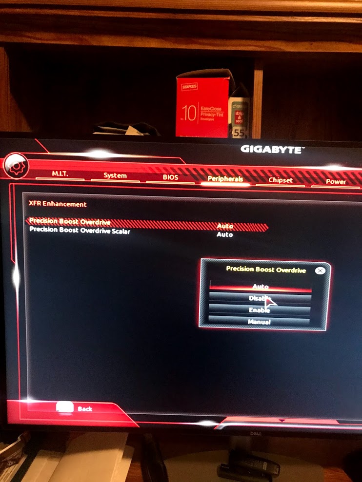

So my friend and I both are curios as to what settings in the bios are required to enable PBO. I know of one setting for PBO under AMD/CBS/XFR Enhancement and the other under AMD Overclocking. As of now we have them set on Auto, but have read elsewhere that you have to set them both to Enable in order for PBO to work. So which setting is it Auto or Enable, and if its not Auto then why, what does Auto do?
I have tried both PBO settings on Enable and noticed no difference from Auto, but that may be because of my board and cooling. My freind on the other hand has a X570 Master with water cooling so maybe he would benefit from it more then I
I would love to understand why there are two separate, yet linked, PBO options in the first place. I guess one is put in by the MB vendor and the other is part of AGESA, but it's just a guess. Seems redundant to have both to me.

All the same I would like to get these two settings clarified, no one seems to really know for sure.
These are the two setting I have, one is under AMD CBS-XFR Enhancement and the other is under AMD Overclocking.
my Gigabyte X370 settings in the AMD Overclocking menu

Okay so this I can work with, now what is the difference from what your settings, and leaving it on Auto or Enable.
Also what does that setting under AMD CBS-Precision Boost Overdrive do, is that for older gen cpus?

Okay so XFR Enhancement I should disable?..........and AMD Overclocking- PBO leave on Auto or Enable. I notice also you can manually set the settings for this.
So just to see if I got this right:
AMD CBS PBO is the older PBO for 1st Gen Ryzen
AMD Overclocking PBO is PBO2 for the newer 3000 series

Which one is which though lol......I have AMD CBS XFR Enhancement PBO......and AMD Overclocking PBO. Both of these settings I currently have on Auto, I get the concept I just want to get the settings right.
Precision Boost Overdrive is NOT new for the Ryzen 3000 series. It's available on the 2nd generation Ryzen's as well along with Precision Boost 2. Nothing changed for Ryzen 3000 on that front. It's the same algorithm for both. What has changed is how you enable them in BIOS. PB2 and PBO are functionally the same thing. The difference is where they get their EDC, TDC, and PPT values from. PB2 uses the processor's defaults. PBO gets them from the motherboard or the user's input. The latter should be more aggressive, but what holds Ryzen back are not these values. This is why PBO essentially does nothing.
So how do you properly enable PBO in the bios? There is a lot of good information in this thread, but I still cant nail down that one aspect of which are the correct settings to enable PBO.
Bios settings:
AMD CBS-XFR Enhancement- Precision Boost Overdrive.......Auto Disable Enable Manual
AMD Overclocking-Precision Boost Overdrive......Auto Disable Enable Advanced

On an MSI, you just enable it in both places. You can also do manual + advanced and set the values, but as the poster above me states it isn't going to do anything. If anything, you may retard it's performance.
So putting them both on Auto or Enable is probably the best method.
You actually have to put them both on enabled. Auto, leaves them in their default state, which is to use Precision Boost 2, not PBO.

Okay well all of these post are some great information and really help clear things up. I believe I finally have a much better understanding of how things work with these CPU’s. Thanks!!
So, does setting PBO to "Disabled" also disable PB2?
No. 'Auto' is disable per AMD. Disable is also disable. It's just a technical nomenclature type of thing that applies to PBO.

No. It does not. Think of it this way, unless you set everything to manual and lock down a specific clock speed, PB2 is effectively always enabled. All PBO does is tell the CPU to override it's PPT, EDC and TDC values and get them from another source. In theory, it should allow the CPU to clock higher more often as the motherboard or user input PPT, EDC and TDC values are much more generous than the CPU's defaults. However, this is not what observe from these CPU's. Meaning, their is another limitation preventing the CPU's from going further with PBO enabled.
To further confuse you, in manual / advanced mode for PBO, there is an offset mode which allows you to raise the boost clock ceiling of the CPU by another 200MHz. Theoretically producing a 4.8GHz 12c/24t CPU using a 3900X as an example. Unfortunately, because other factors limit boost clocks, this doesn't actually happen either. I've never seen the offset add anything to the actual observed clock speeds of the CPU under any workload.
Really, unless you are doing manual overclocking, just leave everything in default settings with these CPU's, besides whatever you need to adjust for your memory.
The biggest problem is that the wording in the UEFI isn't very clear. The reason for this is that AMD told motherboard manufacturers that they had to have a menu for PBO that was essentially the same on all motherboards regardless of manufacturer. The motherboard manufacturers also kept the layout and menus they were using the same, so effectively, you get it in two places and though they impact one another to a degree, you have to set it in both places in order for things to work right. It's stupid, but AMD wanted to make sure that all the motherboard makers were on the same page when it came to tuning menus.
