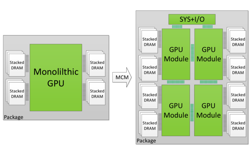

new patent submitted to the US Patent Office on December 31 describes the AMD approach to potential GPU chiplet design, by implementing ‘high bandwidth passive crosslinks.
According to the patent, a primary GPU chipset would be direct ‘communicably coupled’ to the CPU, while each of the secondary GPU chiplets in the array would be coupled to the first GPU via a passive crosslink.
In this sense, AMD considered passive crosslink as communication wires between chiplets that are placed on a single interposer. (in multiple layers if needed).
In conventional GPU designs, each of the GPU features its own last-level cache (LLC), but in order to avoid problematic synchronization, AMD thinks that each of the GPU chiplets should feature its own LLC, but in a way that each of those caches is ‘communicably coupled’ to physical resources so that the cache remains ‘unified and remains coherent across all GPU chiplets’.
Source: Freepatents via @davideneco25320

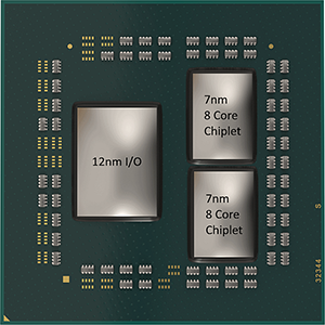

Well with Ryzen they choose 12nm for business reasons. 7nm Fab space was at a very high premium when Ryzen 2 launched. 12nm made perfect sense. They also get fantastic yields on those 12nm controllers dropping costs even lower.
By the time they build a GPU with this... its very likely the controller will be 7nm and the actual GPU dies will be 5nm. However nothing stopping them from going 5 or 7 nm for all the bits.
If the controller in a GPU is a lot more important then the controller in their CPUs there isn't anything stopping them from over engineering it.
If a Chiplet Radeon has a 12nm controller die at 125mm2 (the exact same size as Ryzens)... and 4 GPU chiplets coming in at 40-80mm2 each. That is orders of magnitude easier to fab then a single 500-600mm2 monolithic GPU. Instead of getting 40-60 working GPUs on a wafer they will easily be looking at 400-500. That will almost double their yields... assuming they can make everything work.
Nothing technically holding this back... they solved the engineering on this already with Ryzen. Yes design wise they will have to make a few different decisions in terms of cache and how the CUs operate. But that is true of all GPUs. Gpu dies are already so massive that they have been building the idea of Core complexes into their designs for years now. We are already at a point where latency to cache for one core over another further away on the die already has to be baked in.

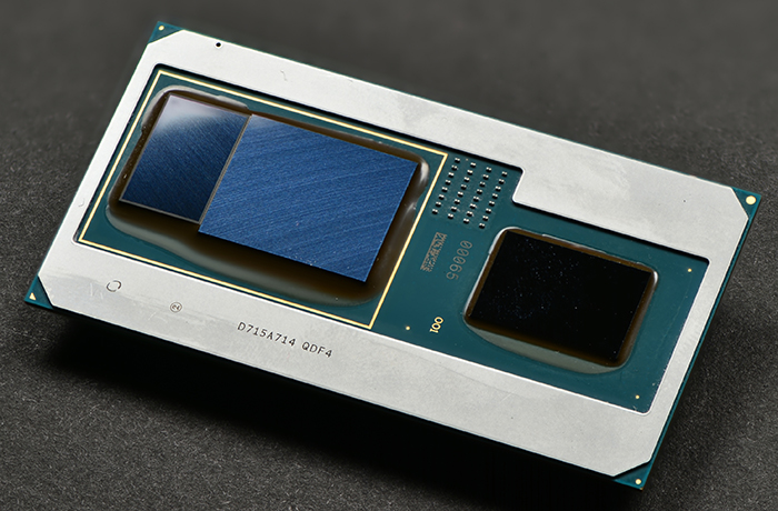

Intel already did this with Kaby Lake-G, but like nobody can buy it. It's also not really a chiplet design, but close enough. I'd be fine using what's in the Xbox Series X or PS5 in a PC setup, if I could buy it for an affordable price. It's not a chiplet design but I'd be up for it. I feel the only reason AMD hasn't pursued this technology for APU's or SOC's is because they don't see it as profitable. They can clearly do it.
Reactions: ChadD
