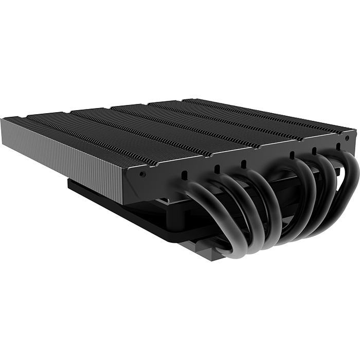

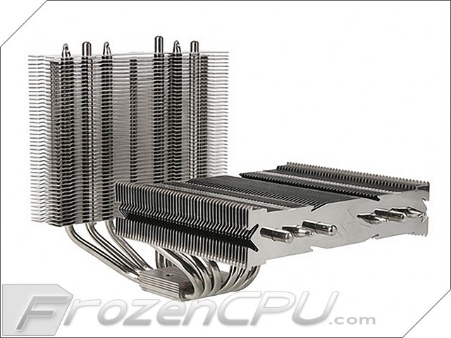

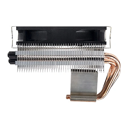

Looking for an offset heatpipe cooler for my AM4 SFF build..... something that looks like the pic below but is inexpensive - anyone know of anything? or could anything be modded to do it?
nope, nope, nope and nope. years ago there were a few like that, sorta, but not inexpensive. you want something so specialized, youre gonna pay for it.
I'm going to take a cheap cooler that looks similar-ish to this, pin it in a vise and bend it to the appropriate angle.
i was going to suggest doing that to a C14 but price... that might work for a low/mid tier chip though.
The other benefit here is that having the pipes pointing vertically (in my use-case) may actually increase cooling capacity of the cooler. These crappy 4 and 5-pipe coolers are all over ebay from $25-35.

Oof, at 120mm, you might be able to squeeze an 80mm tower cooler in there...92mm at most. Are you planning to use that same case? Does it have a vent above the CPU? If so, a phat noctua l9 cooler (or similar) might be more suitable.
most of the cheap crappy ones are 92mm or less so that is what I will be using. I may have to angle it a bit to accommodate the length (which should be fine). The reason for this is so that I can get the 5.25" bay filled properly.

I looked at the product page a minute ago, and it says 71mm max height on the CPU cooler. You might be able to get a taller one in if you remove the shroud, though. The Noctua L9x65 would be just a bit short with the included fan. Just about any tower cooler will be too tall without modification.

I'm seeing roughly 140mm from the motherboard to the top of the case, so figure 130-135mm of available height from the top of the motherboard. Rough measurement.
I think it's going to be close - the board I have has VRM heatsinks right next to the CPU socket so the bend will have to be pretty aggressive. I'd way prefer that this thing bend straight up but if it has to be cocked off at an angle that would work too.
I'm going to look for one that has the smallest pipe-bend radius and the shortest fin-stack. It's going to have to be tight.
this is the best I've found so far but I'm going to keep looking.

If all else fails I could remove a section of fins from the top and bend the pipe to accommodate (I have a pipe bender that will work with this diameter of pipe). I could epoxy or attach an aluminum heat-spreader plate at the top and use thermal pad on the top of the case. should be easy to do.

The only problem with bending heatpipes is that, just like tubing, they tend to kink.
If you get a kink or even just a spot where the tube collapses in on itself a little bit, you can kiss the functionality of that tube goodbye.
Bending also messes with the calculated internal vacuum so too much bend and the heatpipe won't work properly.
Also the insides of the pipes often have a semi porous ish coating in them. If it’s breaks apart when bent, it could really change how effective the cooler is.
I believe this has to do with the wicking mechanism for when the pipes are installed in sub-optimal orientations (i.e. upside-down, horizontally etc). My use-case will have these running vertically so this should be optimal

The big shuriken 3 rev. B is too tall and too big - it will interfere with the 5.25 bay which is what I'm trying to avoid.
I have a Noctua D9L on one of my AM4 CPUs that does ok. It's only 110mm tall and would probably work fine if you limited the TDP of the CPU.
Although it sounds like you want something to bend around where the 5.25 bay is. Hard to visualize. Do you have the same case as the reddit thread you posted? Maybe you could find something like an old HSF out of a Shuttle XPC box?
Pics would definitely help. I have a feeling that there may be a cooler from a Dell that might be made to work.
Does the stuff you are putting in the drive bay totally cover the CPU socket, or does it just slightly interfere or what?

Both too big. Ideally this would be a 5 or 6 pipe cooler that runs to the back exhaust port on the case... So if you took that second cooler and chopped the horizontal side of the pipes off that would be more like what im after
How much space do you have between the board and the drive bay? The first one I linked is pretty much the lowest profile cooler available.
the space is roughly the size of a factory AMD wraith cooler base heatsink (i.e. without the fan and shroud) I can't measure it right now because I'm in the middle of doing something really important with it lol.

Are you 100% sure the first one I linked to won't work?
