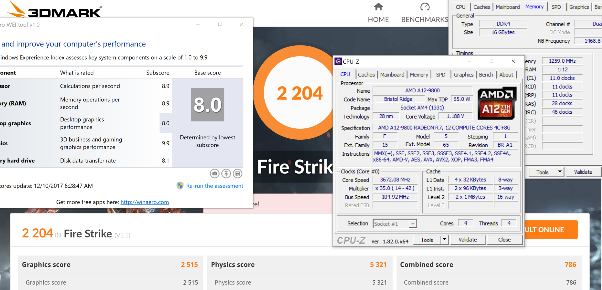

ARRGHHH so close to 2200! I will try again tomorrow:
I couldn't get cas 10 working even when dropping down to 2400 mhz, but i was very happy with theses timings: 11,11,11,28,48 with a 352 trfc @2520 mhz. Strangely, it is still 352/1056 even with the Flarex - must be a MB thing.
The CPU portion is crap compared to Godvari. 41 x 105 Mhz is stable, but 42 x 104 Mhz (4368 mhz) took every last mV and even then only worked half the time. Godvari was good for 4700 mhz at least.
the Physics portion of FS consumed 180 watts @ 4.7 ghz with Godvari, but a whopping 210+ watts @ 4.3 ghz with this turd. I am really surprised the score is this high compared to my Godvari chip.

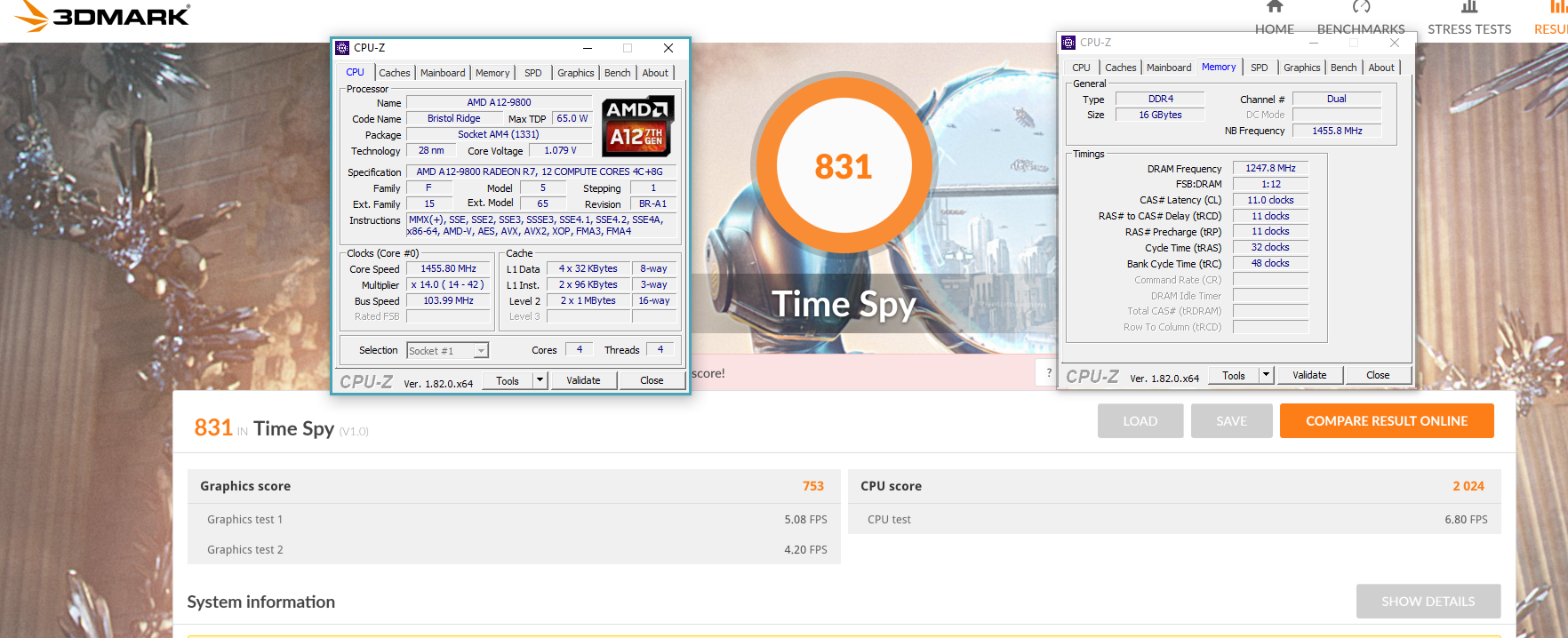

Finally!
I tried Timespy with the same settings but it crashed. I dialed it down a bit and got a 794 but noticed temps hit 89*! The CPU portion of the test was running at 240 watts, peaking to 250 watts. My poor motherboard LOL. So I put the H80i fans on max and managed to hit an 831 :)
Keep in mind that the 2700u only managed to get a 915. Are you kidding me?? So a 4/8 Ryzen - Vega APU only manages 10% more performance in gaming than a 2/4 Bulldozer - R7?! Yeah I know the desktop versions will clock much higher, but I was hoping for a MINIMUM of 2x performance when comparing o/c to o/c. Raven Ridge is looking to be disappointing when compared to this glorified Kaveri from Jan 2014. That chip will be 4 years old by the time Raven Ridge desktop is for sale, and this is the performance boost we get?!
Finally!
I think the thermal limit is killing the potential performance here. These new chips dynamically throttle to maintain their TDP.
