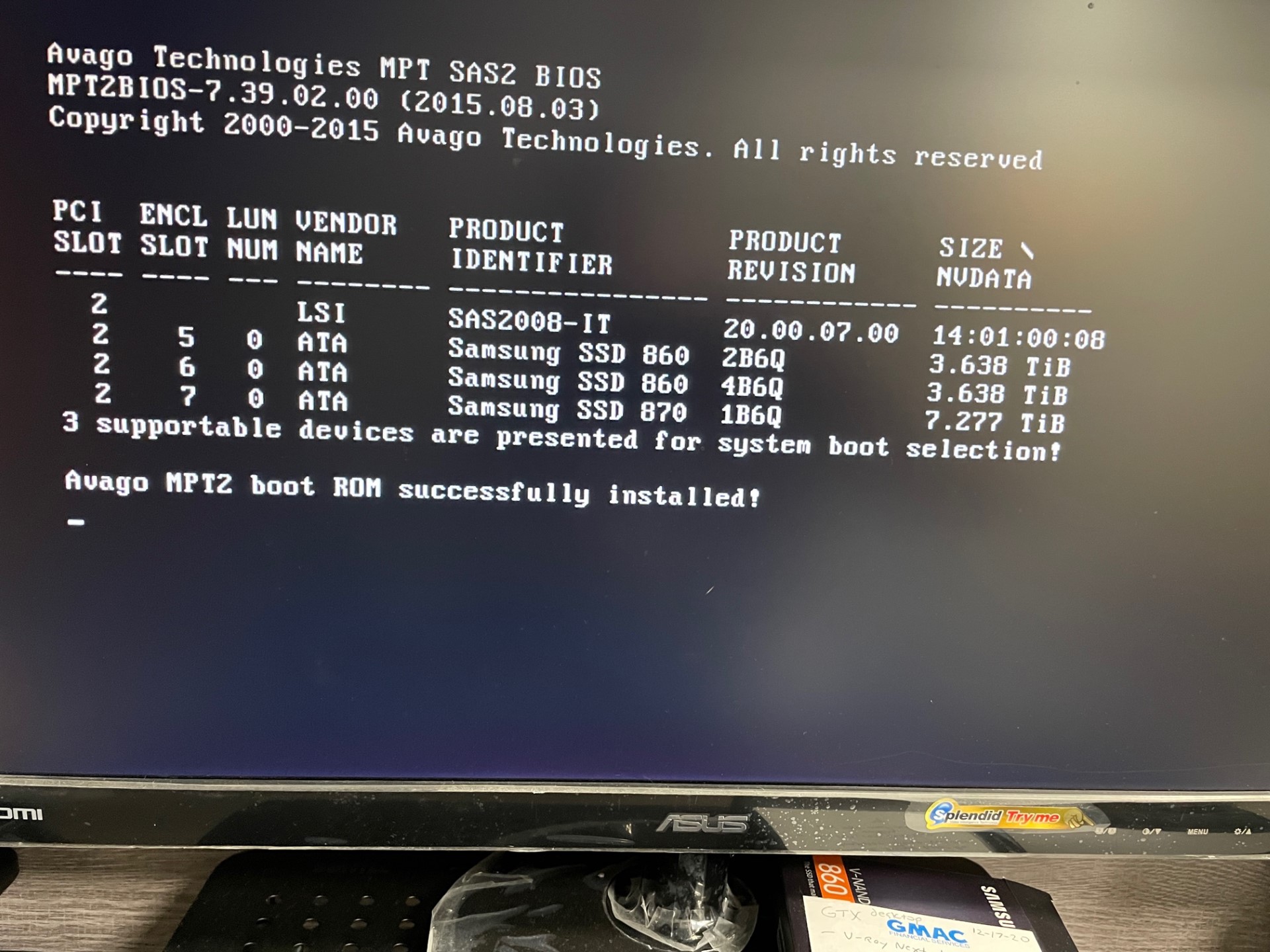

C:> is connected directly to the MB and so is one more SSD. And then I have an SAS card with 3 SSD drives connected to it marked P2, P3, P4). SAS Cable P1 is not connected to any drive.
I do not have a screenshot of the boot or bias screens before the problem but here are some screens now.

Here is link to SAS card

C:> is a 2TB SSD Samsung EVO. The other SSDs are 4TBs and 8TB.

I tried removing the SAS card and leaving only the c: SSD connected to MB. I tried connecting the SAS cable P1 to the C: SSD. Then I got the "reboot and select proper boot device" the last 2 pics, Windows is loading file, communication error.
