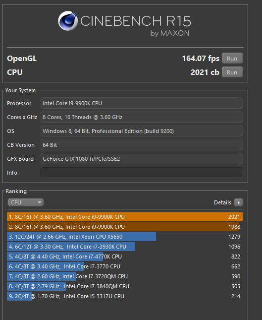

Let me put it this way.....I just ran this with a 1080ti.
