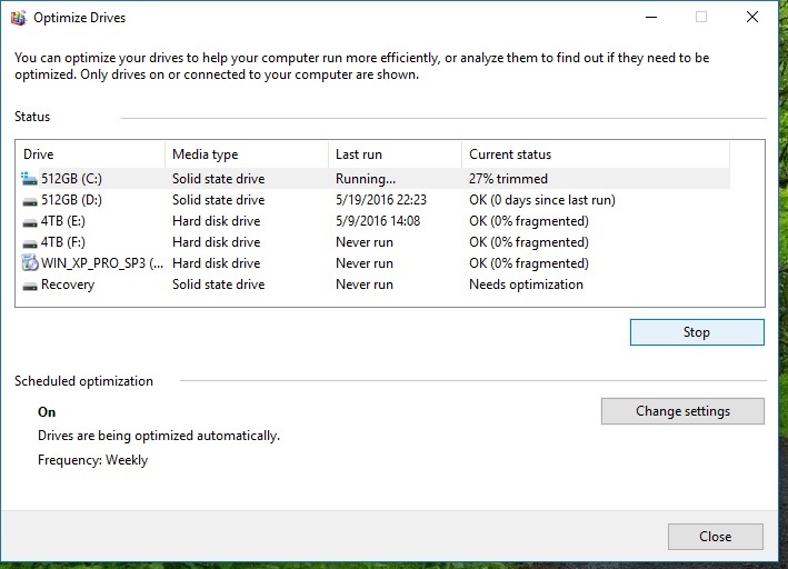

You will need to type "defrag" when you click start, yes defrag. Windows 10's trim is broken. I have it set to run once a day but it actually doesn't. a friend of mine had to show me this...

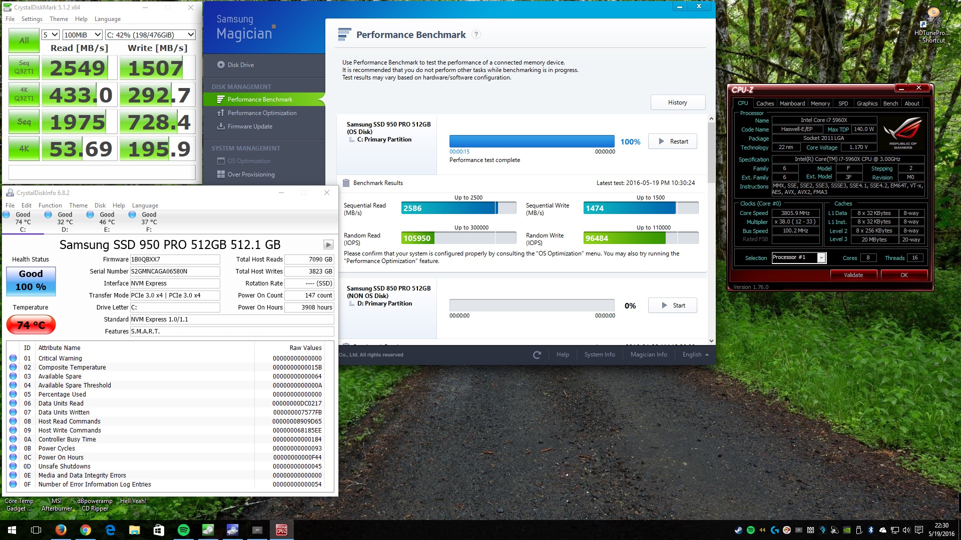

To quote several people, no, those numbers are not normal. I have the Samsung 950 Pro 512GB and I get advertised speeds, sometimes higher.
There are a couple of things. You will need to install the NVME driver from Samsungs website.
and two, the device itself may be getting too hot. If it does, it thermally throttles.
Trying to figure out how to attach a couple of screen shots..
Click on them below..
The drive runs pretty hot.. which I do not like.
You will see two benchmarks, but both show advertised speeds. although a little low on iOPS for some reason..
My motherboard is an ASUS X99-E WS board...
The drive itself is in an M.2 slot, PCIe 3.0 x4 interface.
