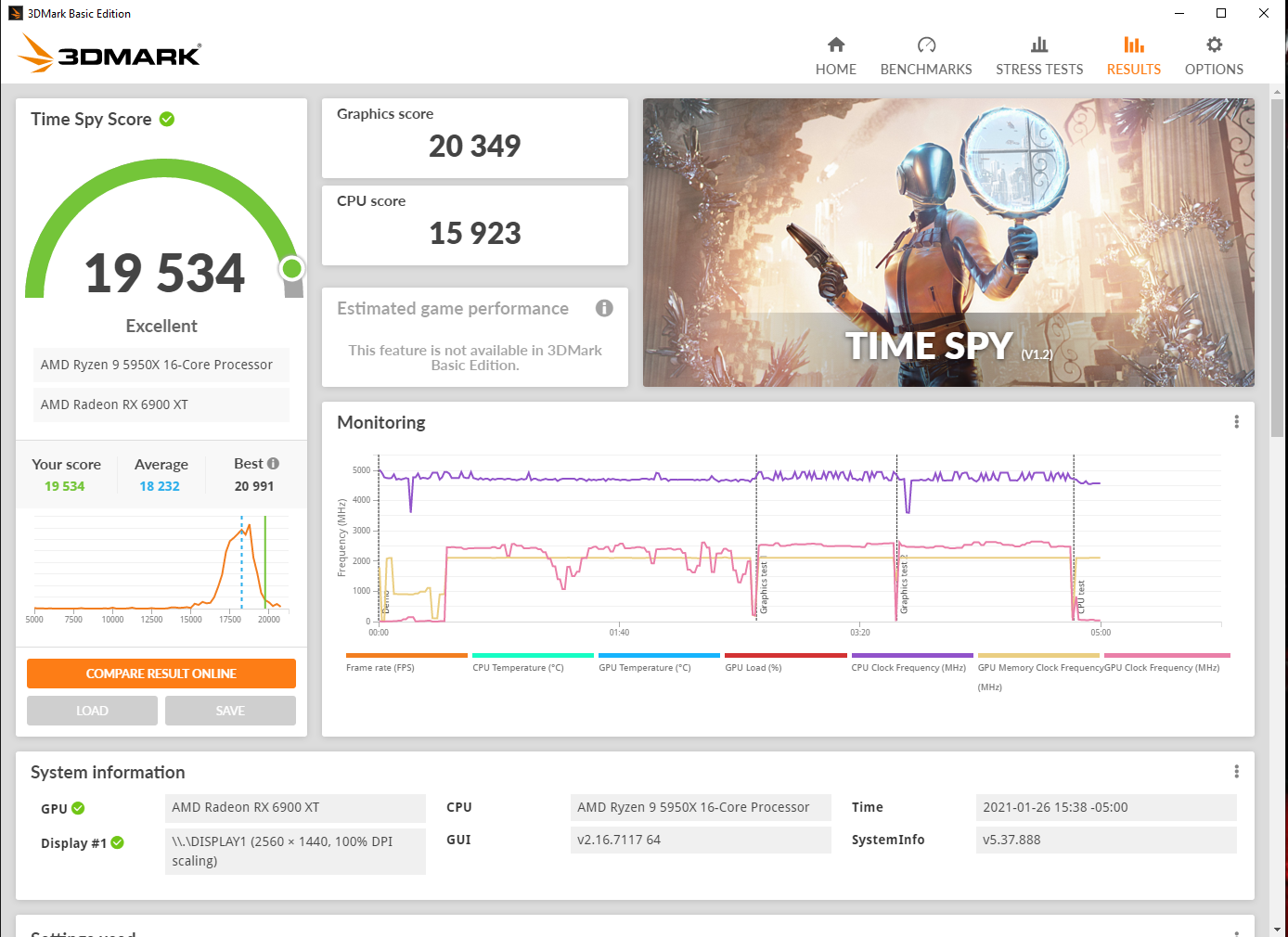

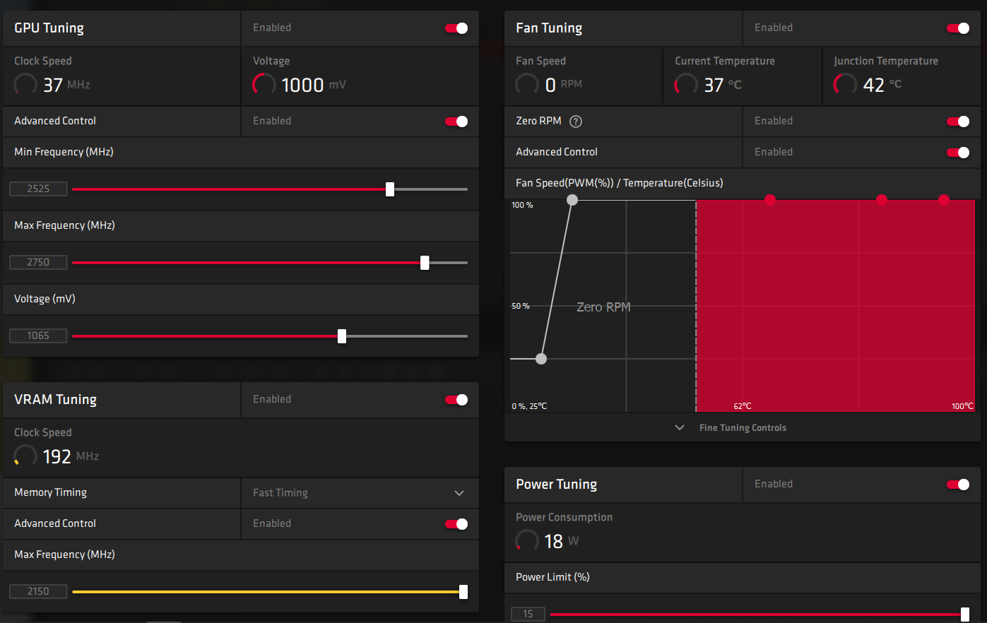

One thing I've noticed with timespy is that I can sometimes get it to finish a pass but it isn't consistently stable. Sometimes a second or third attempt results in a CTD or a lock-up.
Below are the settings I'm currently on that seem to work well in timespy. No memory overclock tried yet. 20K plus should be within grasp here. I did try these settings in TD2 this morning. I had a single CTD after 3+ hours however I'm not sure if it's due to the overclock or just the game crashing for some other reason. Regardless, I'm going to hold here for a while and run some further game testing then maybe next weekend if all is well move on to some memory overclocking. If I have any further issues, will bump up vcore to 1090-1100mv.

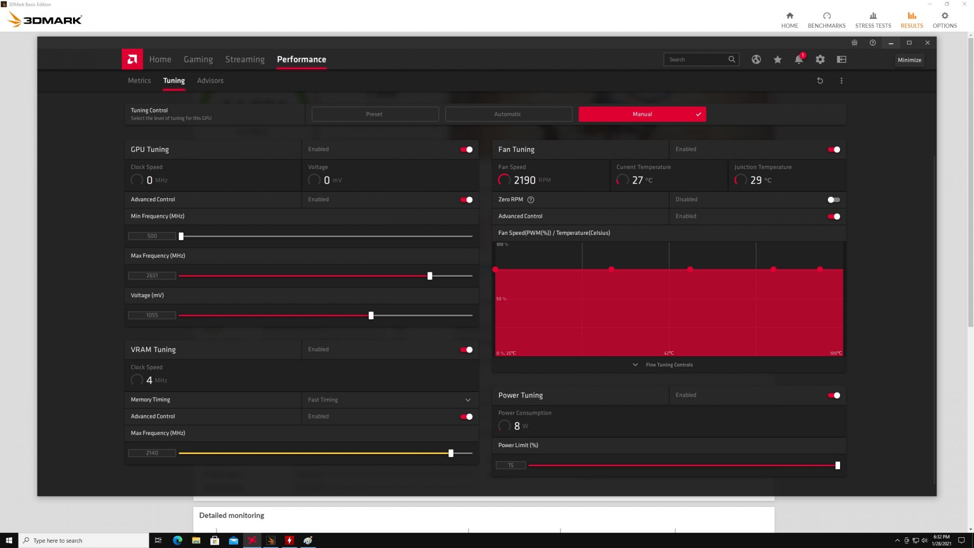

could you be kind enough to post your MPT settings by chance? Im still on air with my Asus TUF 6900XT and have my "watts" set to 325w with MPT, with that said, I can only cool 347w (7% power limit) then hotspot gets to 100c+ and driver crashes card CTD will occur. Hoping when a company finally releases a FCWB for this card, i can tame it enough to be able to use the full 15% powerlimit to 375watts and see if I can finally break 21000 in TimeSpy! Pretty sure I can, atleast im hoping. Would just like to see what you are running. this is my absolute best score ive been able to achieve on air with MPT, however ive been yet to achieve it twice.... its like the moon and stars have to be aligned perfectly LOL!
