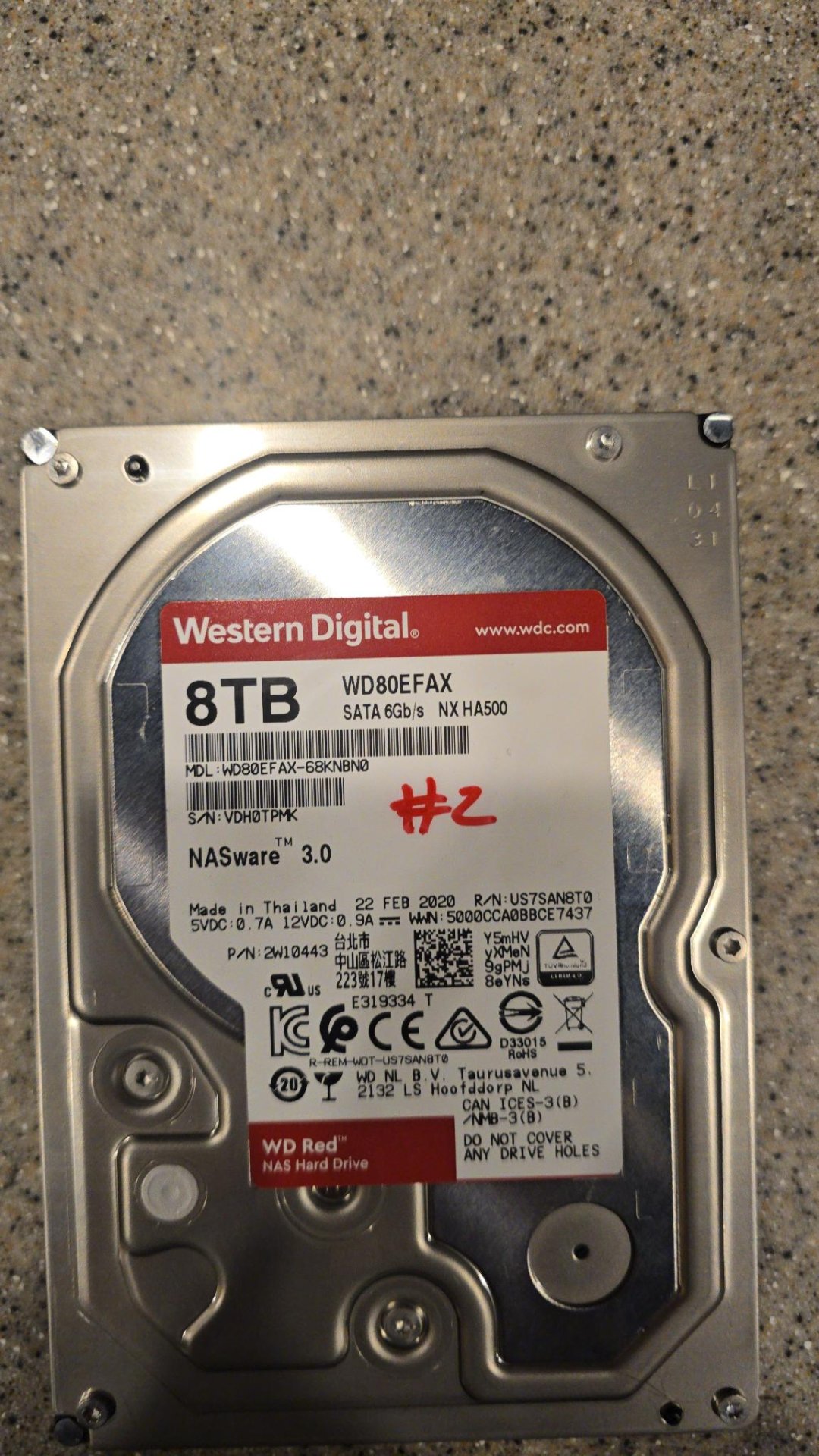

Because I am curious, what type and vintage of WD Red drives are they? Regular WD Red, or WD Red Pro? And what manufacture year?
I can't help but wonder if the drives are of the vintage where WD moved their Red drives to SMR tech.... That seems to have greatly impacted reliability. 😥

Here is a pic of one of them. They are Red regular
