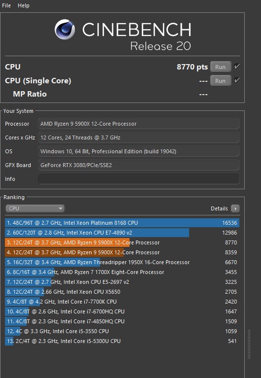

Posting my cinebench scores in case you are interested. The score of 8359 is stock and 8770 is with PBO and 627 single core with PBO off. Single core score drops when PBO is on, not sure why. Not much gain for a whole lot of watts. Keep in mind that the CPU will throttle on watts. Mine stays at at 195w average. My guess is yours throttles a bit more. The D15 is a great cooler, but once you run PBO with a 200w limit you are close if not above the thermal limit of the D15. At stock 142w it should work very well if noise is not a factor (needs high speed on case fans to provide fresh air vs. a front mounted rad).

Intersting thing is that PBO only gives 6-7% at the expense of a massive temp and power gap and no I have no real world cases that benefit from it so I just leave it off unless testing thermals or benchmarking for fun.

I confirm that PBO gives you a insignificant performance boost for a huge amount of additional power.

That's what I found through the course of this thread. PBO while increasing my CBR20 score by about 800 points, shot temps through the roof. Probably power too, I didn't look at that. It basically just takes the CPU out of any reasonable binning limits for not a lot of gain. I assume it's better to leave enabled as most tasks are shorter bursts and not as heavily threaded as CBR20. It does look like you're at 3600MHz on your RAM while I'm at 3200, which is going to make up the sort of difference we're seeing between my system and yours in multithreaded results. I could bump mine up probably, just don't want to.
