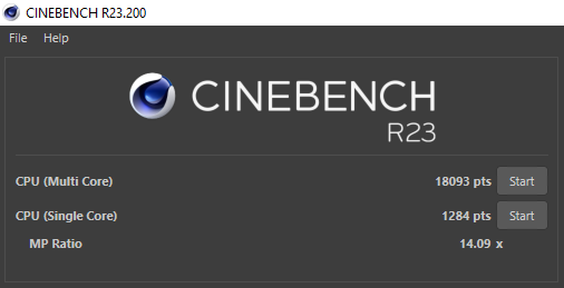

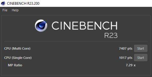

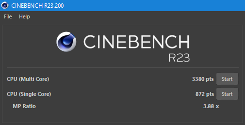

Here are some benchmarks I ran recently, comparing the 3900X in my main computer with the 5820k in my backup computer as well as another computer that is still running an overclocked 2500K:
AMD Ryzen 9 3900X 12C/24T (Stock with PBO)
Intel Core-i7 5820K 6C/12T (Overclocked to 4.5Ghz)
Intel Core-i5 2500K 4C/4T (Overclocked to 4.5Ghz)
