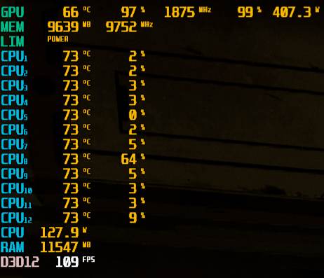

Dead Space Remake (4K maxed 120hz) with ARCTIC Liquid Freezer II 240. The version I got apparently had the wrong parts, I emailed ARCTIC and they sent me a backplate that was supposed to be compatible with AM4 but it was exactly the same as stock so I went to the hardware store and bought screws long enough to fit it. Thermal paste is MX5. Pretty sure it's screwed in good. IDK been thinking of swapping to a Peerless Assassin 120. This is before the Ryzen Master manual CPU -.03 voltage setting.
Thanks! I played a game for a few hours and what a dramatic difference in the ambient temp in the room, much less hot now. 👍

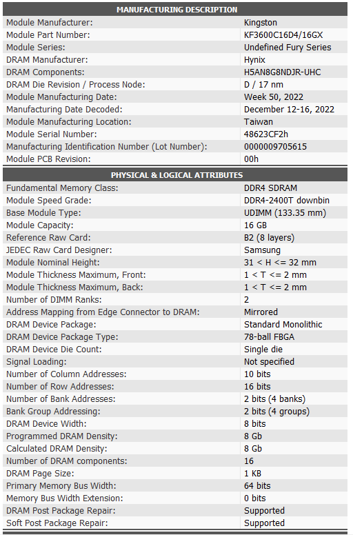

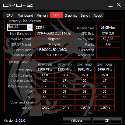

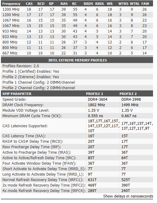

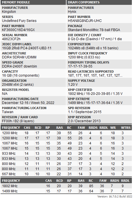

Can you post screenshots of:
1. CPU-Z, tab memory
2. Thaiphoon burner (you can download it here: http://www.softnology.biz/files.html, choose the freeware version)
We can check the IC of your memory from those 2 screenshots, then determine the right settings / tuning for the IC.

I'll definitely do that today but...
I have the newest BIOS available. Here is the ram:

Based on freq 3600 with cas 16, and then quite loose trcd at 20, I would guess its Micron E-Die (quite good overclocker to be honest).
Micron E-Die can't go lower on trcd, so you may try 16-20-16-16 with 1.35v on vdimm, using 3200mhz first.
If boot, then you can try 3600 18-24-18-18 1.35v, using VSoC 1.15v.

It's Hynix RAM, under the branding. So, good chance it will be nearly impossible to dial in the CL speeds. Never know, but I have had zero flexibility with my CL on my Hynix 4600 Mhz RAM.

1. Don't send back that ram, yet. hehe
That Hynix DJR is only behind Samsung B-Die in terms of pure frequency scaling.
2. But DJR has it's own caveat: you have to manually tuning your primary and secondary timing, even sub if necessary to maintain the stability at 3600 and higher speed.
Hynix DJR default timings you have there as XMP are optimized for Intel platform (skylake, ADL, and Raptor), so obviously for Ryzen you have to manually adjust and if you can find the stability, that IC is beast.
3. Your 5600x can probably run 4 sticks of Hynix (2 CJR IC, 2 DJR IC) at 3600 with settings like this:
Primary: cl16 - trcdrd 18 - trcdwr 8 - trp 21 - tras 42 - trc 63
Sub: tFAW 20 - tWR 20 - tRFC 560 - tRDRDSCL 5 - tWRWRSCL 5 - tCWL 16 - tRTP10 - tRDWR 9 - tWRRD 3
ProcODT: 40.0 ohm
