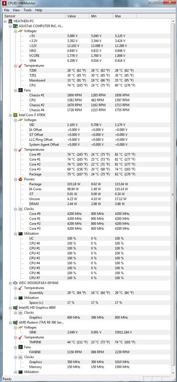

I upgraded my sons system from a i5 4460 to an i7 4790k. I bought a Phanteks TC14PE to go with it thinking I would get an OC out of it, wow was I wrong.
The case has good airflow, and I have reseatted the cooler many times thinking I did something wrong.
I decided to do a worst case scenario since it is winter here, room temp was roughly 18C when this was tested.
I ran Unigine Heaven until the GPU was warmed up then started Prime 95 27.7 Small FFT's non avx on stock settings, I will let the picture speak for itself.
Honestly I was pretty shocked, I have an i5 OCed and it never came close to these temps at stock. Live and learn I guess...
Something is amiss, wrong mounting bracket? Forget thermal paste? Motherboard carried over a voltage setting for the CPU from the previous CPU you had? Def not right.

Voltage is 1.170 max, most of the time it is 1.163.
I have taken the cooler off many times and checked the contact and it seems good.
I loaded optimized defaults and left everything on auto. I am not sure how much it adds to the temps but the iGPU is running a second monitor.
If I run AIDA64 or Prime 95 blend it maxes out about 65C, like I said, I wanted to run a worst case scenario so I ran Heaven and Prime 95 at the same time and this was the result.
I would have said not that bad (80c is still very safe on those CPUs, Intel only starts throttling them around 100c) but then I noticed the 4.2ghz clockspeed and the CPU fanspeed (1600rpm) - plus you said non AVX. That definitely does not look right to me. I get those temps too right now but that's with my CPU fans at 900rpm, 4.4ghz on all cores and 1.23v. I have the iGPU disabled but I doubt it matters that much. Also I have only 2 case fans total running at 1000rpm (it's a Fractal R5 so airflow is good but not the best either).

I did try overclocking, 4.8 Ghz @ 1.315 was perfectly stable at gaming. Temps were too high for me trying to stress test (95C + 1st minute), that is when I decided to stress at stock and add some GPU load to the mix.
