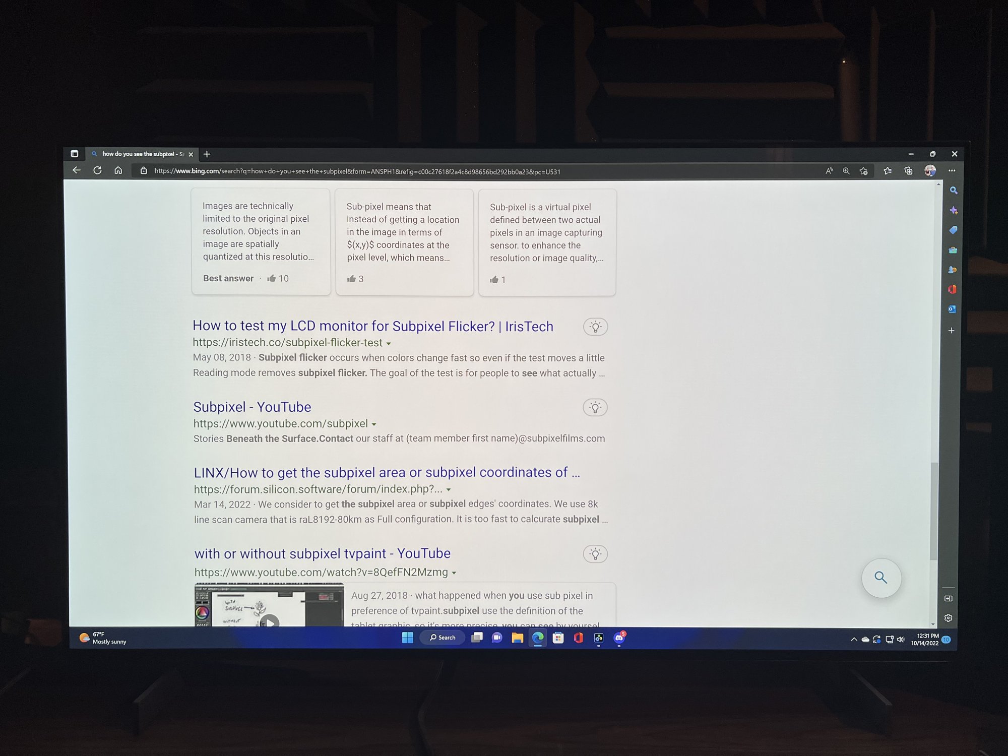

I got a LG C2 42" OLED from Amazon during the recent prime sale and hooked it up tonight. It has a blue tinge on left and right on a white screen with a white background like a browser or notepad, and I can even see it a bit on this hardforum page as the white text on the far left and far right is slightly different color than the white text in the center.

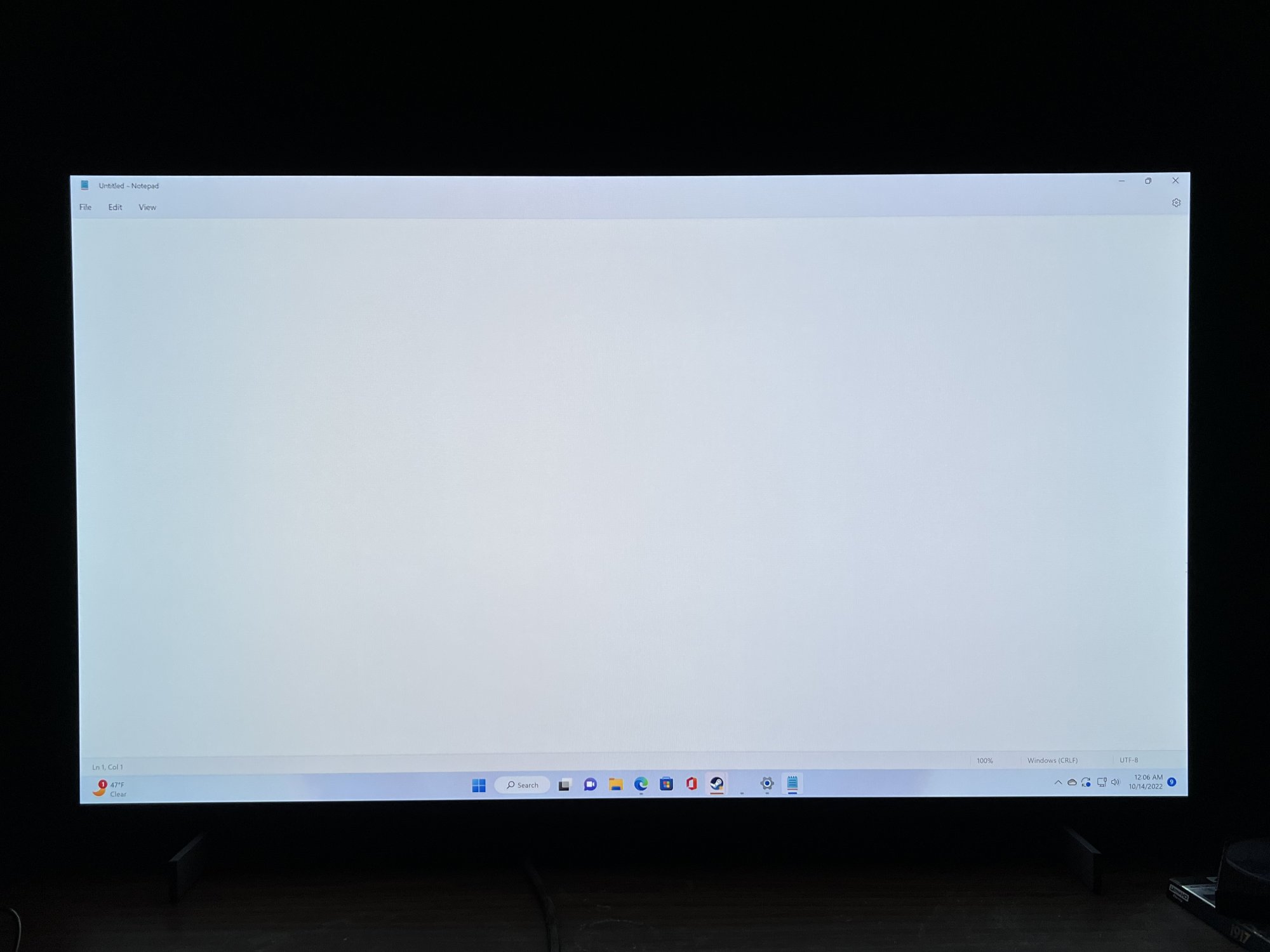

Here’s a white notepad for reference
Is white uniformity imperfection something that is normal on these OLED displays? It isn't terrible, and maybe I'm being too picky, but I'm not enamored about that aspect of this monitor. Otherwise it looks fantastic! Black levels, coming from a 34" Alienware IPS LCD are in a different league all together.
Is this something that might improve with a bit of break-in or would you return it? If I wasn’t using it as a desktop monitor I doubt I’d ever notice with streaming media and cinema type content.
This is my first OLED and I’m not sure how picky I should be about uniformity — I’m thinking this might be something that bothers me a bit though and disparages my ongoing enjoyment of the OLED monitor if I can’t get it fixed.
I have a regular LED LCD monitor a 43" Viewsonic VX series, viewing your upload, it's as you describe it, a somehow noticeable blue on the side, and white at the center. Now, w/ or w/o a OLED monitor, in the past 10 to 20 yr., I never set my screen to white, because I find white very bright and hurtful to my eyes. I type a lot of document and some spreadsheet, so the whole page of foreground where the text goes is set to beige and I really like it

How far away from the screen are your eyeballs?
When you sit closer to "off angle" uniformity suffering displays like VA and OLED, you will cause the issue to be more noticeable. The closer you sit, the larger the off color or shaded area on the sides will be - much like sitting off center on a lot of displays, viewing from an angle. You technically are viewing the sides of the screen from an angle when sitting too close. There is a sweet spot in the middle at a fair distance.
Like rtings 48cx review said:
Like most OLED TVs, the LG 48 CX OLED has very wide horizontal viewing angles. However, colors shift quickly when moving off-center. This makes the colors appear inaccurate at the sides when sitting up close and when viewing from the side, which isn't ideal for content creation.
60 PPD , 64 deg viewing angle at 4k <--- pushes the extents of the screen outside of human viewpoint a bit compromising the viewing angle
48" 4k screen at ~ 33.5" away
42" 4k screen at ~ 29" away
80 PPD , 48 deg viewing angle at 4k <--- forms an ~equilaterial triangle/pyramid viewing angle with the screen as the base.
48" 4k screen at ~ 47" away
42" 4k screen at ~ 41" away

Anywhere I walk in the room, the blue tint is on the sides. I tried that yesterday as a test.
I’ll be juggling returns before I would start trying to accommodate stopping using single colors. (White for instance). The black levels are glorious on the OLED, but they are only one characteristic of a monitor and there are other characteristics that matter. I am not one who thinks it is the single most important characteristic and is willing to change my use cases to accommodate.
The Alienware 34” QD-OLED a friend has and says his specimen is perfect with no color uniformity issues. If LG cannot deliver such an experience, then perhaps Alienware or Samsung can.
I do appreciate you taking the time to share some suggestions! About as far as I’m willing to take accommodations however is to try to “break in” the panel with the first 100 hours or so of bright vidid content YouTube playback like some have recommended to see if that fixes it. If not it’s going back. I did change my theme to dark, which I normally don’t like — but I’m not going to try to wrestle all my software preferences and defaults to cover a flaw in an expensive display device. Personally speaking.
I was just posting that in reply to HappyHopping's grey background comment in general for any screen comfort wise.
Yeah I'd try centered on screen viewing angle/your head to the center of the screen at 36" and 41" away to your eyeballs, with a measuring tape, and see what it looks like at those particular distances.
Otherwise you are sitting at an off angle by sitting too close to the screen. The closer you sit, the larger the off angle uniformity issues will grow on the screen.
A lot of people buy larger oleds and try to use them in "up against the wall like a bookshelf" or "upright piano with sheet music" type setups. At those nearer distances you end up with lower PPD and thus text fringing and graphics aliasing, and will have compromised viewing angles for seeing the screen extents as well as exacerbating any viewing angle uniformity issues.
You might have a particularly bad one though uniformity wise idk.
Regardless these are really media and gaming displays - that some try to use square peg in a round hole as static desktop/app displays with tradeoffs. If you need a more accurate monitor that isn't going to suffer aggressive ABL dimming in HDR content viewing/authoring/editing etc. there are 32inch 1600nit pro art screens. Even then, no matter what you get there are going to be some tradeoffs of some sort - but in this case it's really not designed to be a static desktop/app monitor in the first place.

My C2 42 from Costco had uniformity as good as the AW fwiw.
