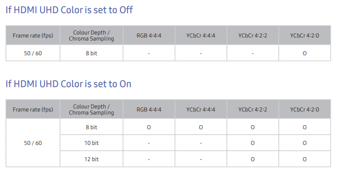

I have an issue with my Samsung UE55KS7500
I don't receive 4:4 :4, only 4:2:2
I enabled hdmi UHD color, slot hdmi 1
I tried with different hdmi cables
NCP settings are okay, full, 32 bit, etc etc
Who is the culprit for not receiving 4:4 :4?
GPU or TV?
Thank you

Did you read the manual? I have a 55MU6290 Sammy, and in the manual I discovered that I can only get 4:4:4 at certain refresh rates. I think 60hz was not included, so the desktop had to be at 23 or 25.
Looks like you have to be at 8 bit for 4:4:4, something to check.

Yeah, you can't run HDR with 4:4:4, there isn't enough bandwidth.
make sure you have it off, and you should be good.
