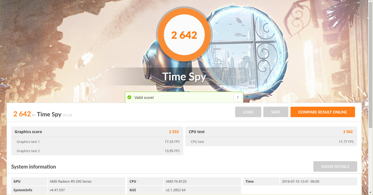

3dmark Time Spy DX12 test

I scored 2 642 in Time Spy
