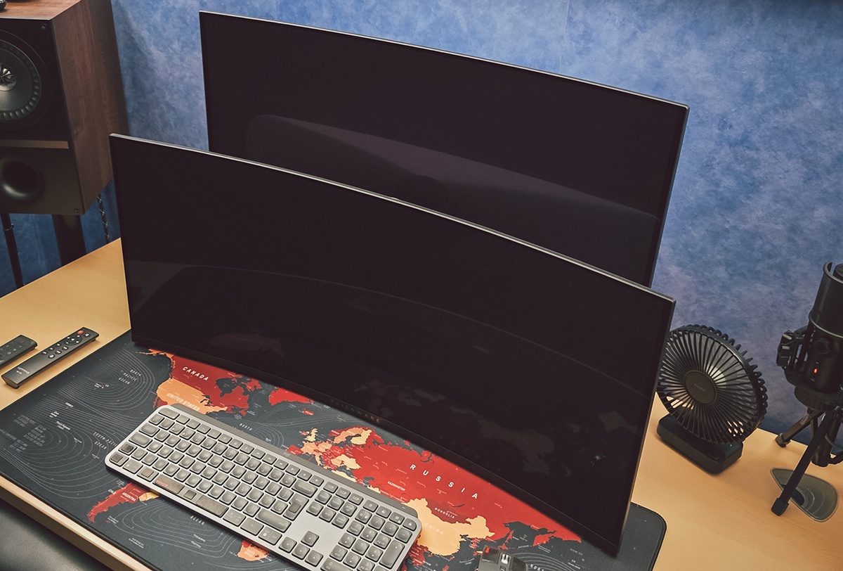

There's really no issue with the curve, it's a mere 1700R unlike some from LG etc which are much tighter and obvious, This quickly feels flat when sat in front of it.
I have the QF, as well as the AW3423DW:
The QF is now my fav monitor, 240Hz vs 175 is 100% noticeable even on desktop with a 1000Hz mouse. The cursor moves much slicker.
Looks great too:
The speed and quality of Dell's CS means I will probably never consider another brand OLED monitor. It's just too good and I've made use of it a lot with the DW since launch.

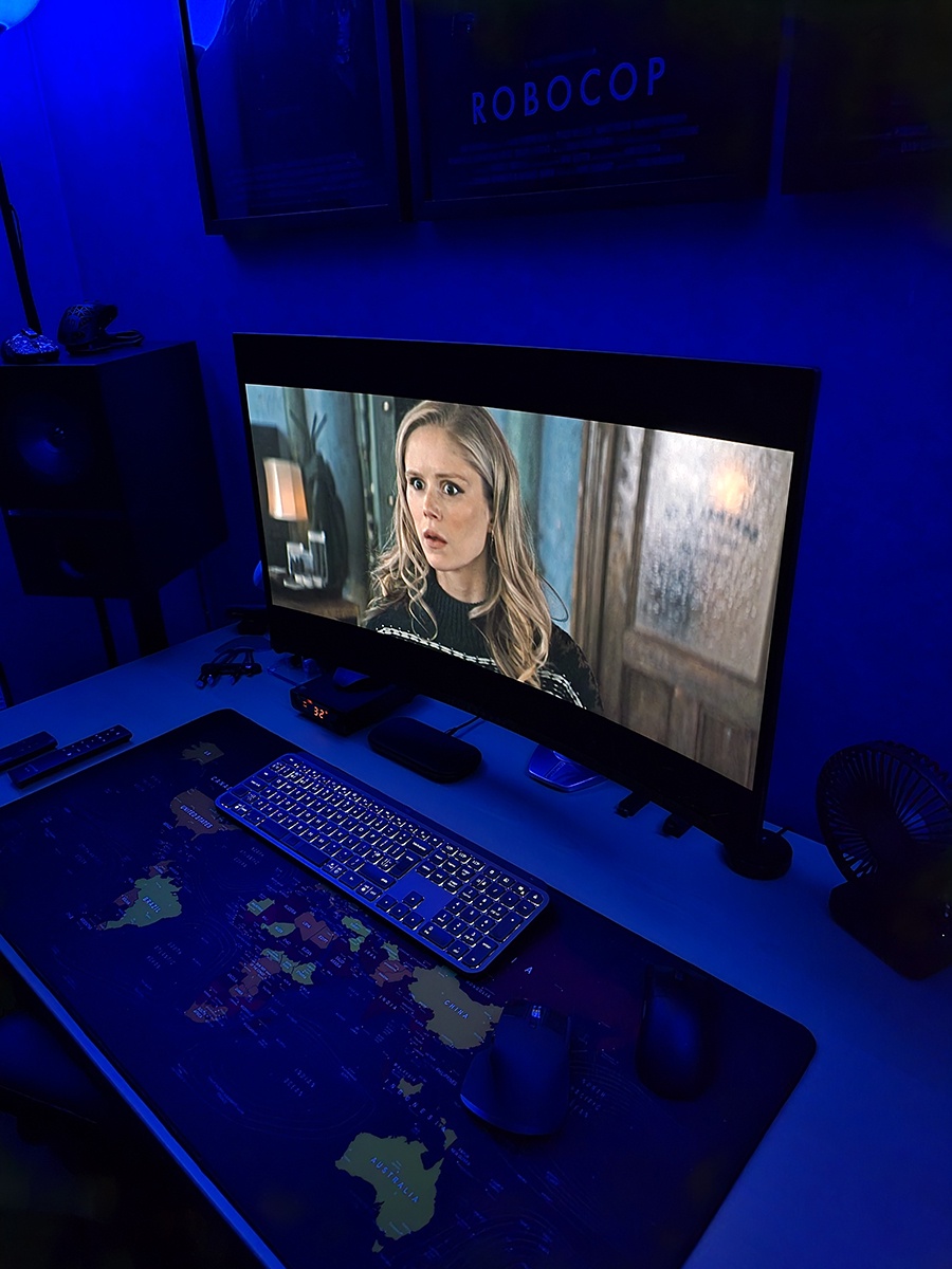

Just been watching house of the dragon on the QF and man, it's rather splendid:
In HDR of course, I actually find the HDR experience greater at my desk than on my living room's 65" LG OLED, probably because at workstation distance things just are crisper on such a pixel dense size, whereas it's not quite the same sat far back in a living room. My PC audio setup beats the TV as well so that defo helps.
