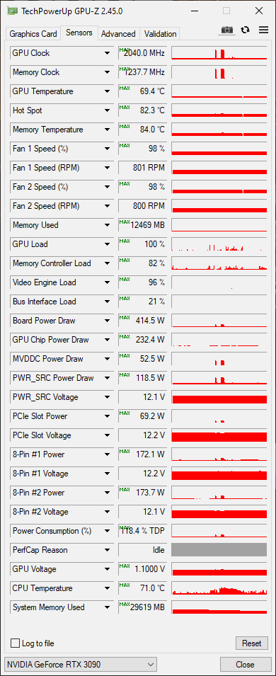

Mine after replacing thermal pads with thermalright extreme odyssey 12.8w/mk
This is overclocked +100 core voltage, +100 core clock, +150 mem clock, 114% power limit
Reactions: pavel
