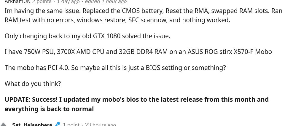

There's a guy in the reddit thread with the same issue on an ASUS X570. Probably not PCI-E 3.0 related.
Has been reported on asus, msi, and gigabyte.

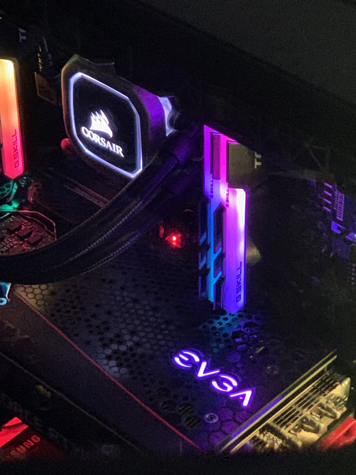

One thing I have noticed also, there’s a red flashing light beside the PCIE release latch, never used to be on before.
