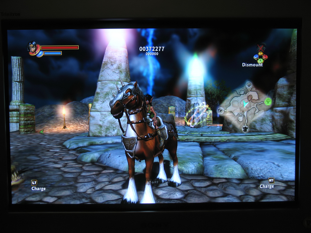

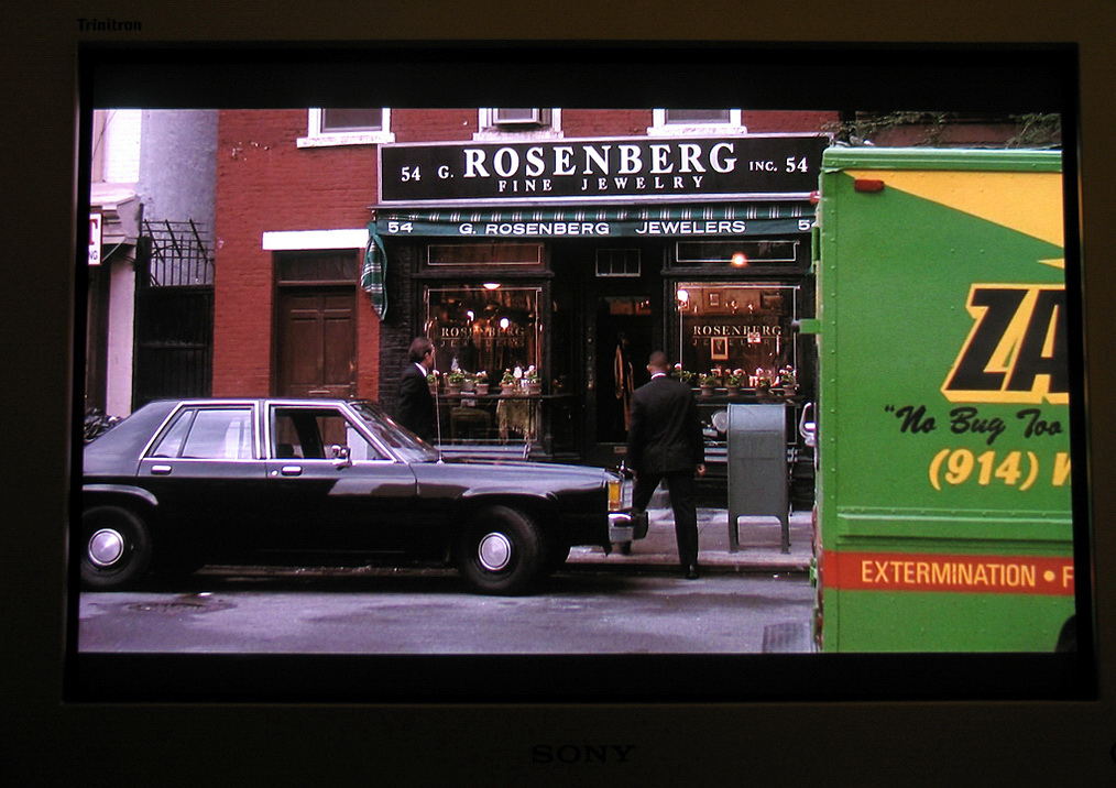

Picture quality on this thing is AWESOME I was very pleased to find the Geometry and Convergence in near perfect condition after looking at various test patterns.Also the overall Focus is excellent corner to corner. It seems as if this monitor wasnt used very much or it just aged very well, I cant see any notable flaws in the picture quality, I havent really messed with it gaming & movie wise but I was just playing FarCry @ 1900x1200 and it looked amazing, I think I got an excellent deal @ $400 shipped,especially considering this monitor retailed for $2,300 new.
Few pics I took, digital camera doesn't really do it justice tho:
