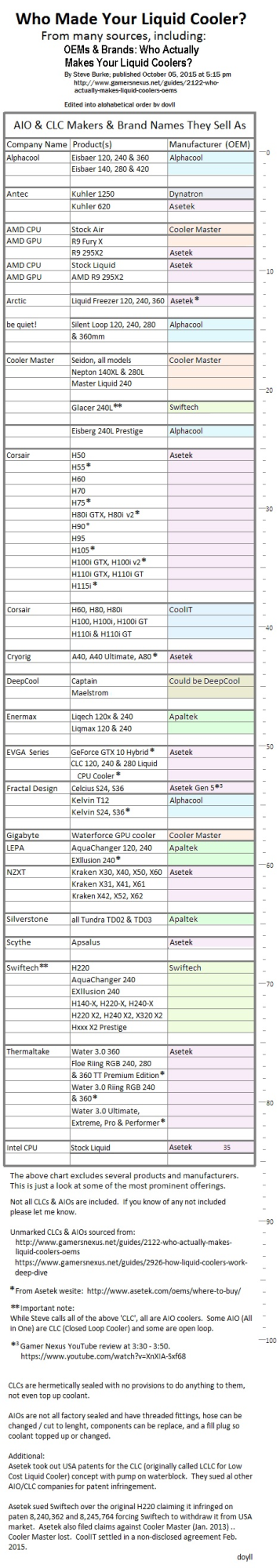

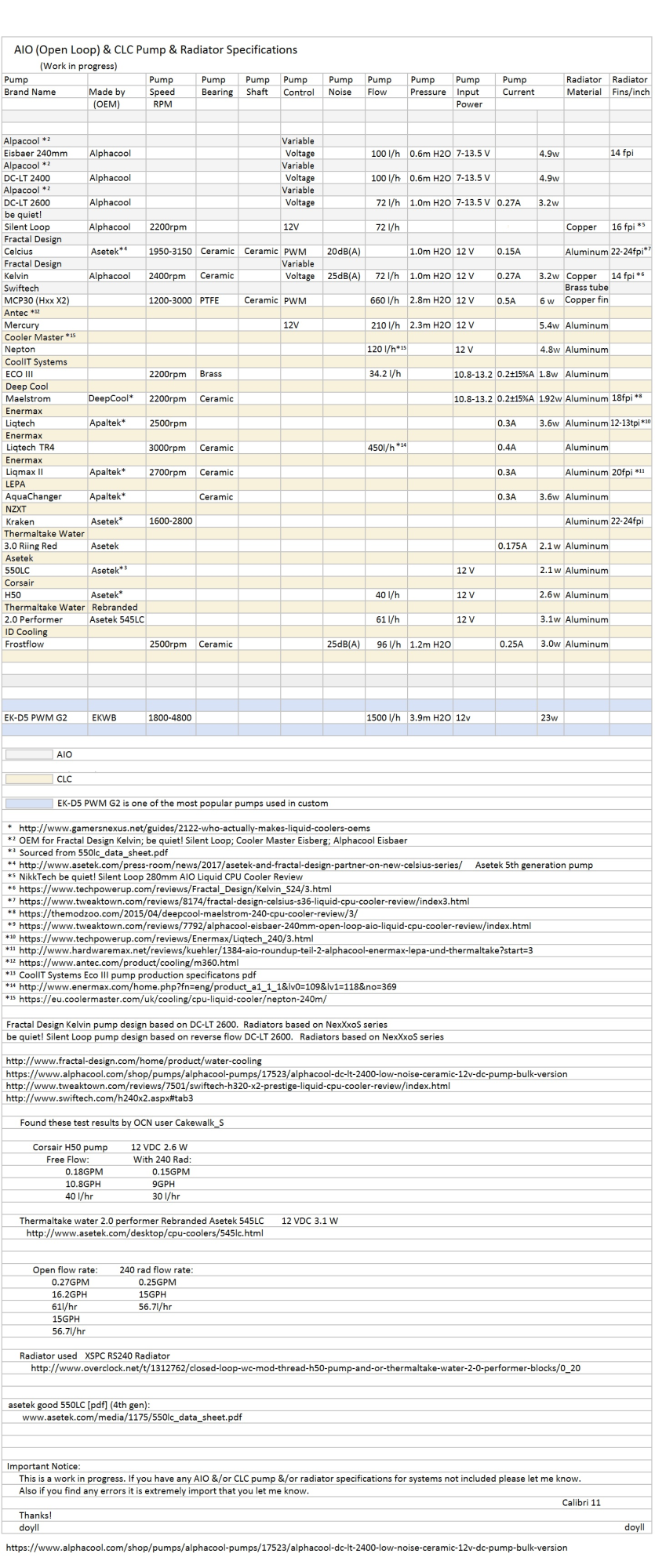

I have a list compiled a few years ago of as much data on AIOs/CLCs I could find showing what OEM the were and what their specs were that I could post.
Post it. I would like a look at that piece of info.
Here's what I did several years ago so obviously out of date as |I did it about 4 1/2 years ago. Figured post it and edit with new data we discuss here.
Here's one with what I could find of radiator construction, pump spec, etc. Again it's about 4 1/2 years old so not at all up to date.

Here is ID-Cooling CLC specs. They are one of a very few CLCs that list pump flow rate and lift specifications. ;)
Please let me know of any errors and of course of more complete data and/or newer data I can include. Greatly appreciated!

As far as I know Corsiar makes nothing .. nothing is Corsair OEM. They contract with other companies to develop and manufacture products they want to market. These other companies then develop it, present it to Corsair for opproval, and after approval manufacture and package complete with Corsair brand name on it. Not a bad thing because most brand names do this. That said, as far as I know Corsair does very little if any of their own R&D (research & development) themselves. Other companies develop product to meet Corsair criteria. Again, something many companies do.
Sorry for slow reply. For some reason I didn't get notice of posts in thread.
Thanks! Not doubting you at all, but would like to have links to sources to include in chart. If it's not too hard to do they would be very helpful.
Found this on reddit and thought it was intersting:posted by
u/ivo09
6 years ago
Very informative, thanks a lot man! I had been wanting to know more info on the Celsius 36.
Indeed! But even more important is they have much better pumps flowing twice or more as much coolant.
"Expandable" means if something goes bad (pump is most common component to go bad in liquid cooling) it can easily be replaced instead of throwing away and having to buy a complete new system.
It also means coolant can be topped up as levels go down, and also drained, flushed and re-filled with new coolant every couple of years.
any tests done on the difference of pump flow within reason? cause on my loop the speed doesn't affect temps as much. (i am not on a Alderlake btw just talking about pump speed)
I've seen data showing way better cooling as flowrate increases from 50L/h up to about 120L/h, starting to round off between 120L/h and 200L/h, then showing little improvement on up to 500-600L/h limit of D5 pumps. We need to keep in mind waterblock and radiator effects as well. I think it's fair to say pumps with flow rates up to 50-60L/h are marginal at best, flow rates up to 100L/h are decent, and flowrates up to 200L/h range are optimal for most applications. Keep in mind the most popular custom loop pump is D5 ( with 1500-1800L/h rating @ 4800rpm with most users running their pumps up to about 2500rpm .. maybe a little more. I haven't used a custom loop in too many years to be sure anymore. ;)
Koolance says
"Flow rate tends to be over-emphasized in PC cooling. For the majority of loops, effective flow rates higher than 1.5-2.0 LPM (0.4-0.5 GPM) won't contribute much, if anything, to thermal performance."\
1,5-2.0LPM is 90-120L/h
Most CLCs have pumps flowing significantly less than that.
I added ID-Cooling CLC specs to my post of data (post #31). If anyone knows of any other CLC specs, please post linke to them so I can add them to above data.
Koolance says
Maybe because my loop has 840mm of alphacool copper? I think I'm running about 20-30% on the ekd5 pump and when I push to above 50-60% i don't see much difference. Is it cause I have plenty of thermal headroom? 6900k 16 thread & 3080Tiftwultra.
Maybe because my loop has 840mm of alphacool copper? I think I'm running about 20-30% on the ekd5 pump and when I push to above 50-60% i don't see much difference. Is it cause I have plenty of thermal headroom? 6900k 16 thread & 3080Tiftwultra.A
840mm of rad obviously helps. Assume you mean EK-D5 pump, so 20-30% would be 300-400L/h cooling 2 components. I'm assuming you don't have a flow meter in system? This means we are guessing at flow rate based on percent of speed, and it's quite possible with that much rad and 2 waterblocks all adding resistance to flow rate that your actual flow rate is less than 20-30% .. like maybe 150-200L/h. Also 2 components are about twice as much heat into coolant so higher flow rate moving more coolant keeps coolant temp lower so it can absorb more heat and keep components cooler as well.
Yea bro I worry about it sometimes because there is a 360 in the front & a 360 on the roof & another 120 on the rear all the same model 30mm alphacool copper. Going through 3 rads and 2 blocks up & down & around I'll be honest I'm extremely proud of the EK D5, the blocks are EK also primochil half inch soft tubing & bitspower fittings. I will experiment again with the pump speed only time i turn it up is to get the bubbles out or even fill the loop because the air traps actually won't pop out without full water pressure it could be because the fittings for the front rad are needed to be on top because the bottom doesn't have enough room so I feel like It's fighting gravity? Lol
Here's a link to Martin's Liquid Lab about number of waterblocks and flowrate to temperature change. Obviously a very old article but still applicable. 0.5GPM is 113.6L/h. You can see increasing flow rate from 0.5GPM to 1.0GPM lowered temp 2.06c while from 1.0 to 1.5 only lowered temp 0.75c, and each additional 0.5GPM increase in flow game less and less temp decrease.
https://www.techpowerup.com/MartinsLiquidLab/MartinsFlowRateEstimator.html
That is very waterblock and radiator specific though so you need the exact same components for the flow estimate to be valid. The change in temps depends a lot on the water block. Some waterblocks see changes of several degrees while others are measured in decimals between 0.5GPM and 1GPM flow rate.
The radiator setup has much more impact than flow rate IMO. Setting up all radiators as either intake or outtake will have more impact. Some radiators as intake and some removing air in the same loop means you get very little cooling from the ones removing air from the case unless you are moving lots of air through the case (additional intake fans). The air coming out of a slim radiator will be closer to water temp than ambient and a fat radiator will make the air close to water temp. The radiators drawing air from the case will operate at much lower efficiency due to the air being much hotter. If all of your fans are attached to radiators then I would expect a 480 as intake to be close to a 360 as intake with 360+120 as outtake.
