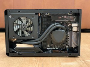

How well would this combo go? Considering no overclocking done.
The AIO is 92mm in rad size: https://store.asetek.com/products/asetek-645lt-92mm-performance-liquid-cpu-cooler
Fan is this slim 92mm from Noctua: https://noctua.at/en/products/fan/nf-a9x14-pwm
Do you guys think this'll be fine in a Dan A4 SFX? Given that no overclocking and run with a slight undervolt?

Yeah in this case pump is above the rad.
Going to see if I can find info on how this affects operation on the 645LT, though Asetek says that it's specifically designed to be mounted on this particular case with this exact orientation.

I'd be more concerned about reviews that use a 240 aio + a 10900k sitting around 70-80c gaming.
You can lower it's boost clock, but enough performance limiting would mean you were better off with a 10600k is such a thermally confined build.

I think it will be fine. I have a 10900k and without an overclock my temps didn't reach 60 in several cpu heavy games using a 280mm AIO. I'm overclocked to 5.2 at 1.295 now and gaming sometimes hits about 76 briefly but usually is in the low to mid 60's or lower. I would not use stock thermal paste get the kryonaut thermal paste it made a 10-15 degrees difference for me. Go for it!!
Also this may help it has a little more potential than the one you picked
https://noctua.at/en/nf-a9x14-pwm-chromax-black-swap
