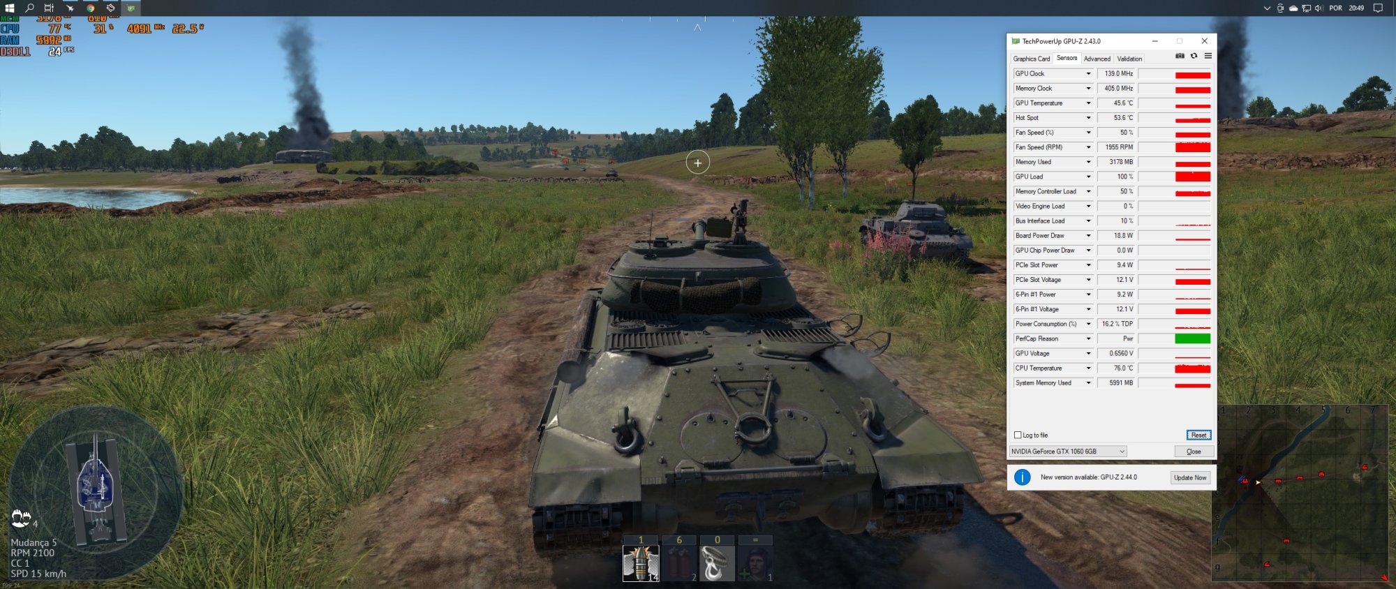

Hi, I'm facing a very strange situation. My video card doesn't work when I play a game. Despite the GPU running at 100%, the temperature, frequency and FPS remain low. VRAM usage is also low. There is simply no difference between the graphics card being idle or running a game, other than using 100% of the GPU.

The big clue is inside your screenshot. The video card memory is only running at 810 MHz. Something is forcing it to run in a down-clocked speed. Try checking your power management settings and the NVIDIA control panel for clock speeds.

That 810MHz VRAM and 139MHz GPU are just the problem. They remain that way regardless of whether the game runs or not. In both the NVIDIA control panel and Windows, the power settings are set to maximum performance. Where can I check VRAM clock speed in NVIDIA control panel?

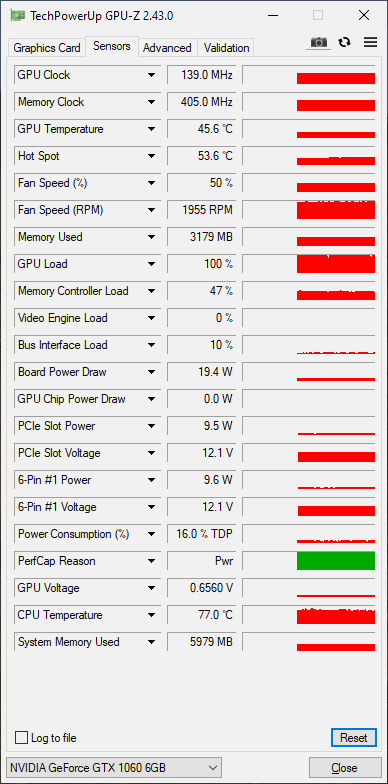

Can you take a screenshot of the Sensors tab in GPU-Z during a benchmark? PerfCap Reason is the most important part.

k, good. make sure the bios is up to date too. if you update it make sure to reset all your settings. also make sure you have the pcie cable seated good. its complaining about not enough power but is limiting the core/rams speeds....

Based on everything I've read you most likely have a hardware failure. I suspect there's a blown resistor/inductor somewhere. Any chance you can take photos of the PCB?
Given the situation, it couldn't be anything else. Unfortunately I don't have a way to photograph the PCB, as I already tried to disassemble this video card a while ago, for cleaning, and I couldn't. Thank you all for the attention! Next week I will evaluate the feasibility of fixing it.
