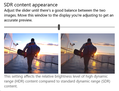

It's sort of a mess. I think Windows just has shoddy support.
Fullscreen games will work fine, but the Windows desktop doesn't work in HDR well (at least not unless I'm missing something).
One thing you can try is this screen:
This is in Display Settings -> Windows HD Color Settings. Scroll to the bottom and move that slider to the right.
It helps, but honestly Windows just doesn't look good in HDR. It's all gray and washed out. If there is a way to fix this proper, please let me know.
However, since only a few games even work in HDR, it's not too bad clicking the HDR switch every time, not ideal though.
Ah thats good to know. So Windows desktop itself is not in HDR mode. Only when you are playing games? I ask this because I have some HDR MKVs i played with default Media player classic but the TV didn't see it as HDR. However when the same MKV is played with the TVs media player it is HDR

For people wondering about the "washed out" colors, it has to do with how Windows handles SDR content (including the Windows desktop and all non-HDR apps) when HDR is enable. See here and here:
https://www.pcworld.com/article/3269591/computers/windows-10-april-2018-update-hdr-settings.html
https://www.dell.com/support/article/us/en/04/sln308136/colors-are-faded-and-washed-out-when-high-dynamic-range-is-enabled-in-windows-10?lang=en
However, I just realized that games can switch to HDR mode themselves, even with HDR disabled in Windows. This basically fixes everything, for some reason I never tested that.
Spent some time tweaking settings tonight and Far Cry 5 looks much more natural with HDR.

Please check the links I posted above. They explain the washed out problem and how to tweak it (we need to wait for Microsoft to fix it).
edo101
Jul 16, 2018
153
I fixed mine by changing my PC icon to HDMI. That fixed the color in a snap. Its not perfect but its definetly way more saturated now. Removing my DP adapter fixed like 80% of my HDR issues.
