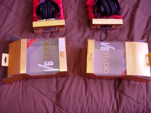

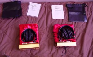

Authentic pair on the left, Counterfeit pair on the right.
The fake headphones came rather loosely packed and did not really form-fit into the packaging like the authentic pair do. The manual is a cheap copy, and the little leather pouch feels like its made out of cheap plastic-leather material, definitely a different kind of leather than the authentic pouch.

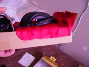

With the fake headphones, the red material is sloppy and hastily attached, on the authentic pair it is clean and professional looking. The boxes are nearly identical but on the fake pair all of the printing is done on a plastic insert that is behind the first plastic layer of the box. On the authentic pair, there is only one layer of plastic, that is part of the box, and its printed directly on there.

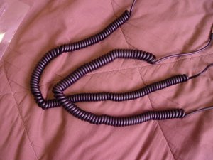

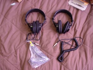

The fake pair did not come with the cord wrapped up while the authentic pair did.

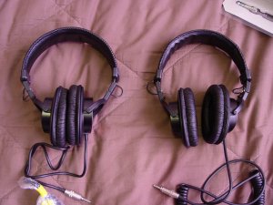

One thing that is immediately obvious is the headband. The authentic pair actually clamps on my head pretty well. The counterfeit pair feels like its about to fall off my head and has very little clamping force. The headband itself is slightly different between the two. The leather material is very slightly different, and the stitching is tighter on the authentic pair. The metal part where you adjust the headphone to fit your head is slightly different. On the authentic pair it slides in and out like a well-oiled machine and you hear a click for every notch. On the counterfeit pair adjusting the size feels like youre adjusting something cheap, and there is much less of a defined click for each notch on the metal.
The cord on the fake pair looks to be made of a slightly cheaper rubber and the cord isnt coiled as tightly (top cord is authentic, bottom is fake).

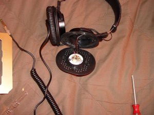

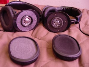

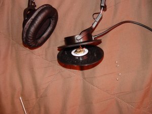

Now were getting to it. There are clear differences in the driver. The metal on the authentic pair feels like thin steel, while the metal on the counterfeit pair is definitely aluminum. The configuration of the holes is slightly different as well.
Authentic on top, fake on bottom. Overall the drivers look a lot closer to each other than I expected. You can tell that there are some differences when you look in through the metal in the front.
Overall, Id say its a pretty good counterfeit. It would be extremely difficult to tell that it was a fake by looking at it without having a real pair sitting right there.
