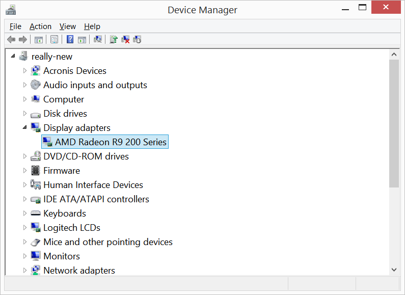

This is how it appears in device manager on my system using windows 10. My asus motherboard is showing code A0 as well but everything is working properly.

sure. however just to let you know it will always show up as 2x 290's in device manager as that is pretty much what the card is.
In win 8.1 only one R9 290 shows if you aren't running something that has an xfire config. At least for my setup.
