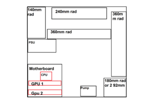

Here is the system lay out I'm thinking of. The case is monster big. And so wide I could put the PSU beside the Motherboard and GPU's and fit dual 240mm in the rear above the motherboard and still have room for a 120mm rad in the rear next to the board.
The front bottom spot has to 92mm fan slots and I do have a few 92mm rads i was thinking of using to save money, but I may put a 180mm or something like that if I can find a rad grill that matches my other grills for such a big rad.

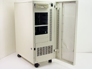

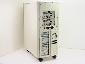

Here are some Photos of the case from when I bought it.
Sadly the mash on the front of the door was damage and I will need to replace it. any ideas
