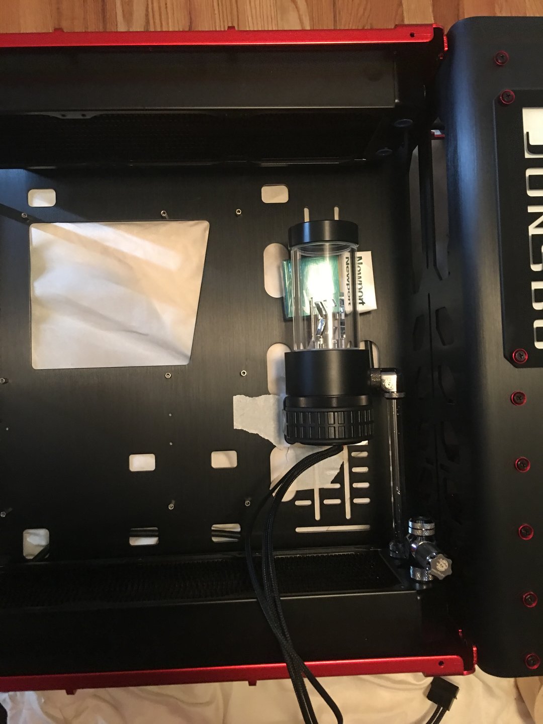

Got all of the parts in, here is my parts list:
Main Components
7900x
Msi X299 Pro Carbon Ac
64gb Skill DDR4 Rgb ram
Samsung 950 pro
Titan xp
Corsair hx1000i
Watercooling
2x Alphacool xt45 rads
6x Gentle Typhoons (for now)
Ek d5 revo with 250mm tube
Ek x299 monoblock
Ek Titan xp water block

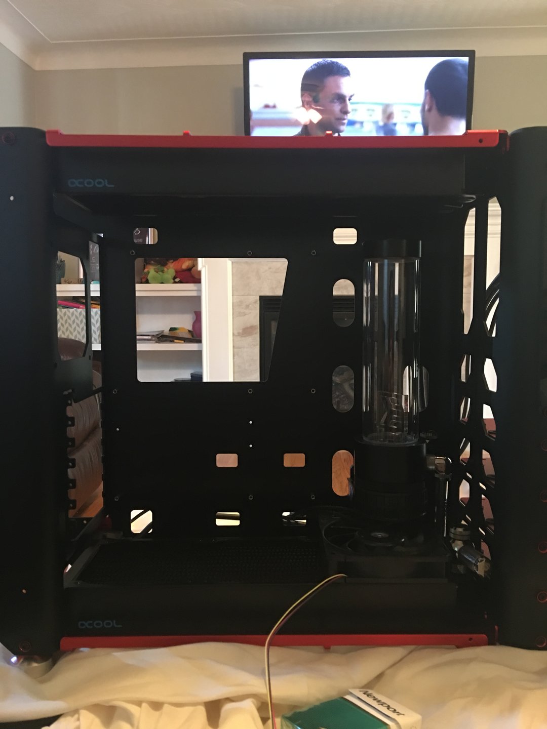

Checking out fitment of 250 tube with rads, going to have to take top right fan off to fill loop but looks much better then the 140mm tube.
