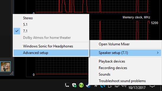

Image attached. Right-click on the speaker icon and you get options like this now. This is awesome if you have 7.1 speakers, but don't want games that only output 5.1 sending surround audio to the wrong (back) surround speakers.

Hmm, It looks different for me "Spatial Sound (off)" instead of 5.1 or 7.1 speakers and don't have any advanced setting there but I suppose Windows senses whether you have 7.1/5.1 speakers or headphones plugged in and only gives it for speaker setups. I'd love to try 5.1 channel mixing Windows Sonic output on my headphones since I think 5.1 speaker setting sounds better than 7.1 on headphones.
You could use Razor's (or other) Synapse software that sets up a software 5.1/7.1 solution to do this, I'd think. Not sure if you can bypass the processing that the Razor software would do, but it's something to try.
