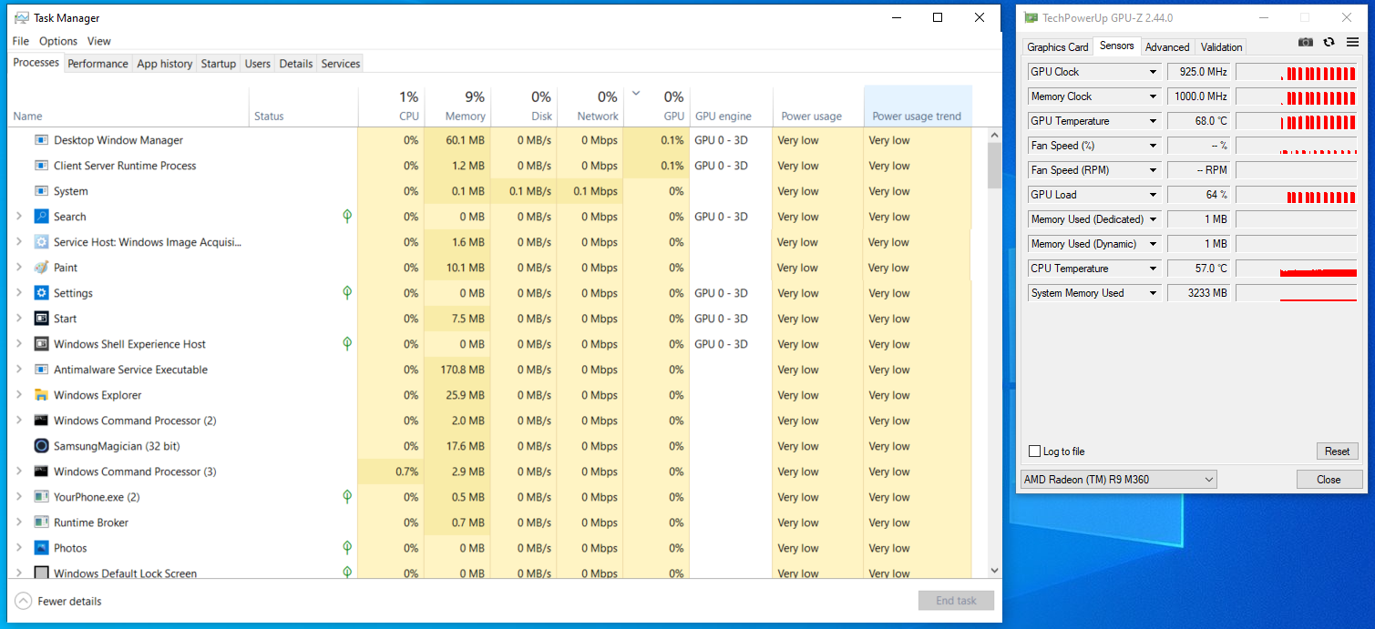

I have a laptop (Dell precision 3510). Normally I used the integrated Intell HD530 video. However, in GPU-z I often see activity on the discrete Radeon R9 M360. It's not all the time - sometimes it's some constant nominal amount. But here it is using the GPU and increasing the GPU temp above the CPU.
If it's not in use, I'd think it ought to be clocked at zero with zero % utilization. Instead, it's doing this. What's the deal here? I'm suspecting some kind of GPU mining trojan, but... av scans find nothing. This is on a fresh win10 install, which I did to see if I could get it to not occur...
The clock speed and util% pulse up to some speed determined by power profile (or unplugging the laptop). You can see it change part way.

Is it possible that GPU-z is actually triggering the behavior by reading the state of the M360?
If you show the GPU usage column in task manager that will show you what is using it.
Nothing is using it. According to TM. GPU0 is the integrated intel HD530
