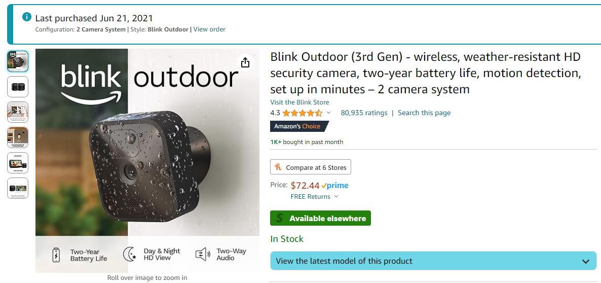

I have this model from a few years ago works pretty good.

I can buy the Blink,
1) how many times you have to change the battery in a year?
2) are you still using the same set? i.e., it has already last you a few year?
3) and the battery that c/w the box is lithium 1.5V. Have you try simple rechargable at 1.2V? although I can buy rechargable at 1.5V now at ebay in the worst case scenario
4) where are all the video sent to? At the USB stick or does it has to send to your cellular phone? Can I have it only to go to my USB stick?
I am still on the same set of batteries, it came with 8 AA Lithium batteries, each camera uses 2, so it comes with an extra set of batteries for the 2 cameras.
If you have a lot of traffic and the cameras get activated a lot, the battery will not last as long.
I have it save to a thumb drive attached to the Blink Sync Module. The other option is to subscribe to the service and the videos are uploaded to the cloud.
Depending on your environment, lithium batteries will be your only option as Alkaline and Nickel Metal Hydride batteries don't like the hot and cold, they will discharge faster. Also not sure if the cameras will work at 2.4 volts.
This is what mine looks like
I've had 4 of the Blink v3 cameras & 2x doorbells for over a year now, and they are still running just fine on the lithium batteries that came with them. They claim they will last 2 years under normal use, so we'll see how that goes...
I have my footage stored on a flash drive attached to the Sync module also, nottaproblemo....and I get an alert on my phone whenever motion is detected, which I can immediately see as a live view (with 2-way audio) or wait to look at later from the drive. And I have them conntected to a separate, hardware-based firewalled networking system from our other networks, with their own UPS & backup power supply, so security of the footage is not a concern IHO...
