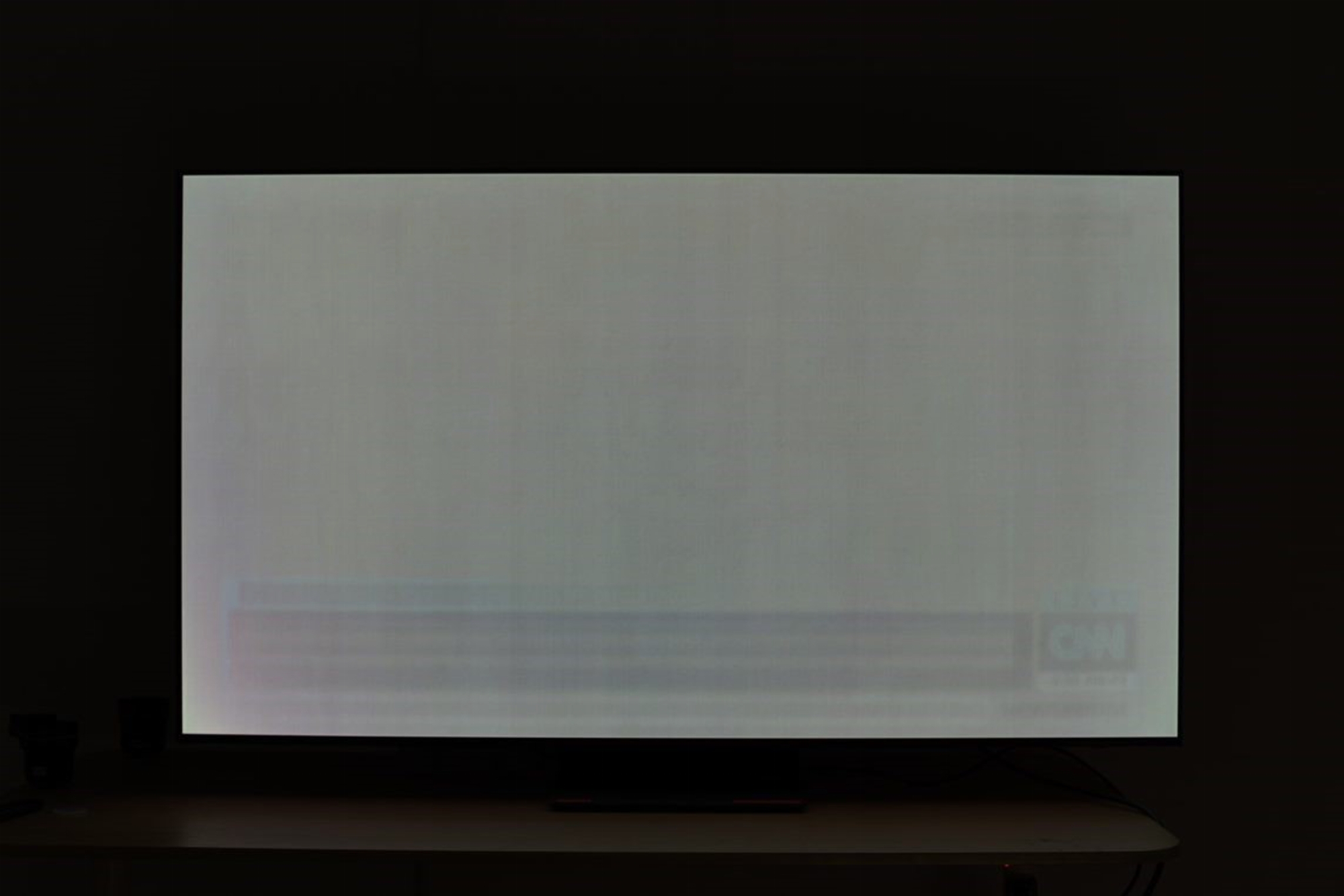

RTINGS: Longevity Burn-In Investigative Paths After 3 Months QD-OLED vs. WOLED, LG vs. Sony, And More
What about PC users; should they avoid using QD-OLED displays? These results don't look good for computer users. A computer's user interface often has large white areas, even if you're using your computer's Dark Mode feature, and those areas are likely to cause burn-in. There are steps you can take to reduce it, though, and as long as you mix up your usage, you probably won't have any issues. It's also unclear if the QD-OLED panels used for computer monitors perform the same. They use different compensation cycles than the TV versions, and this could play an important role in reducing image retention or preventing burn-in. We're looking into possibly adding a QD-OLED monitor like the Dell Alienware AW3423DW or AW3423DWF or the Samsung OLED G8 to the test temporarily to see how they perform. Let us know if this is something you're interested in or if you have any ideas for why these QD-OLED panels might perform differently when used as a TV compared to the Monitor implementations.
Interesting findings by Rtings.com about OLED burn-in. As always, I will strictly use my LG C1 OLED TV for gaming and media consumption only. If I ever consider an OLED monitor, it would be for a dedicated gaming PC and I would go W-OLED over QD-OLED.

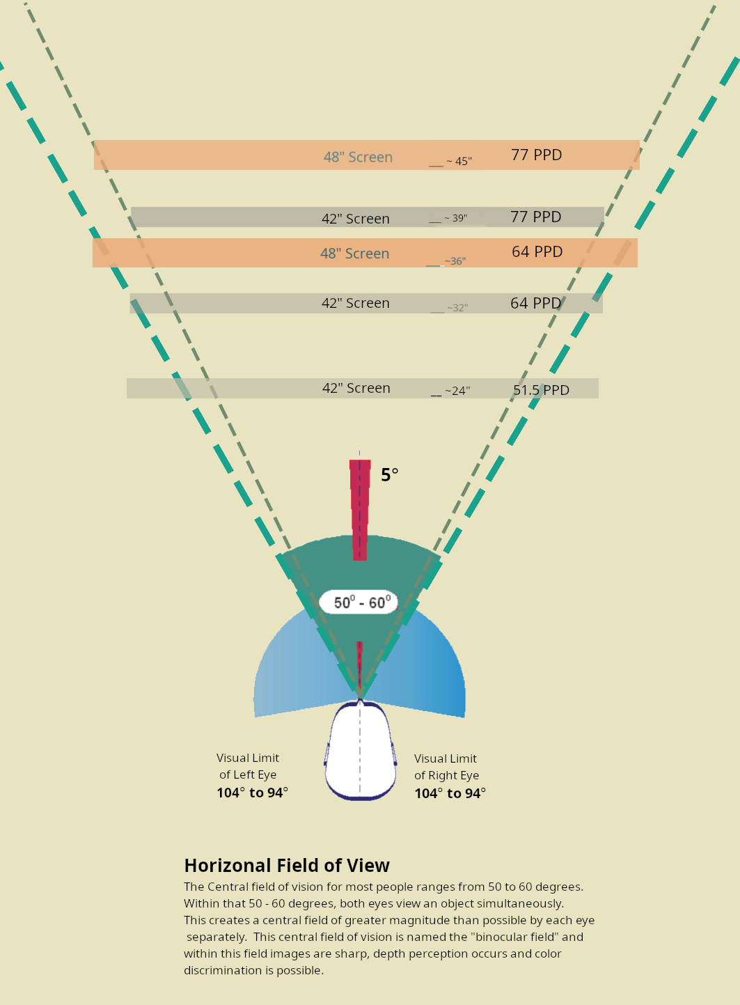

1400p to 1500p like perceived pixel sizes at sub 60 PPD (e.g ~50 PPD) on a larger 4k screen viewed too near will will look fringed regardless but wrgb will make it look even worse because the subpixel smudging isn't aligned to it.
Once your drop below 60ppd , text sub sampling and graphics anti aliasing can't compensate fully anymore even on rgb though.
In addition, 2D desktop graphics and imagery have no sub sampling or AA to smooth/smudge/blur the edges so they will remain uncompensated, have no masking.

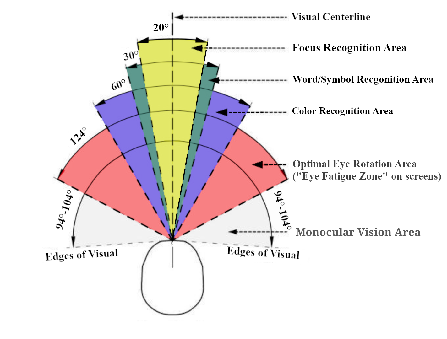

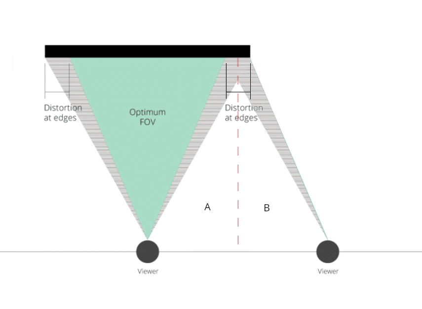

At the optimal 50 to 60 degree human viewing angle you get 64 to 77ppd on a 4k screen.
It's not some crazy distance relative to screen size. It's the optimal human viewing angle and it's the same viewing angle and PPD regardless of the (4k) screen size. It would have the same pixels per degree and perceived pixel size as a 27 inch 4k at around 23 inch view distance ( ~70PPD). The higher the PPD, the less you have to lean on masking how large the pixel structure appears.

Be noted -- there are two kinds of image retention behaviors for OLEDs, with very different causes. One is the phosphorescent-style effect (the temp image retention that lasts for moments or a few minutes, without needing a Pixel Refresh), and the other is the permanent wear-and-tear-based burn in. Those people who have seen those phosphorescent-style effects of some OLEDs, should not confuse that with wear-based burn in.
Now that being said, the RTINGS test show that some OLEDs have poorly optimized Pixel Refresh logic. It's pretty important to have good Pixel Refresh logic in an OLED. And one that is very user friendly (e.g. pausable/interruptible), whereupon Pixel Refresh resumes at the last pixel left off, the moment a user tries to use the OLED while the display is in the middle of a Pixel Refresh. The algorithms behind Pixel Refresh are pretty incredible powerful FPGA engineering feats equivalent of create a few million personal electricians babysitting every single OLED subpixel with a voltmeter/multimeter, computing a bunch of Ohm's Law stuff, running through a LUT, and readjusting a variable power supply on a per-subpixel basis... Well, I'm certainly glorifying, but in a roundabout way, that's what Pixel Refresh is.

The fact is, even LTT acknowledges me, if you're a whole-video watcher;
Also, I execute more mitigations on my OLED than LTT does; I don't use 100% brightness -- not necessary for office usage scenarios with gaming in between;
You will eventually burn in your OLED, given enough time. All displays have wear and tear. Being that said, we are already reaching the point where you can approach full tech-gadget lifecycle with an OLED without reaching objectionable burn in anymore.
As a LG CX 48" owner, the reason why Linus has burn in is because he never bothered to adapt his workflow to try to mitigate it in any way. He can do this because if it burns in, he makes a video of it and that pays for the TV.
For us normal folk, just doing some mitigation that is a one time setup will help a lot. Here are the tactics I used:
  • Don't run it super bright in desktop use. I used the same 120 nits I use on any LCD.
  • Hide the taskbar/dock/topbar. You gained some desktop space and lost a thing that doesn't need to be there most of the time and pops up just by putting your mouse to the bottom.
  • Set up a blank screensaver that triggers before display sleep. I used 10 minutes.
  • Set display sleep to shorter time than on a LCD. I used 15 or 20 minutes.
  • Turn the TV off from the remote if you take a longer break like go to lunch or something.
  • Use a black desktop background. I almost never see my desktop anyway. Alternatively use a slideshow with lots of pictures.
  • Hide desktop icons. Again, I don't use the desktop for anything so don't care about these.
The way I see it, LG C9 and up should be relatively safe for burn-in as long as you take a bit of effort to mitigate it. If this is not ok for you, use a LCD instead.
Yep. While I mitigate more than LTT, I don't even mitigate to THAT extent. I'm a 75%-Brightness setting person + automatic display sleep + dark mode + orbit setting. I don't turn off ABL. 75% also just so happens to be the factory default setting on the 240Hz OLED I'm also testing out privately;
C9 and up is correct (when executing mitigations). C2 can be abused somewhat more with fewer mitigations (default settings are now pretty burn-in resistant). Yes, risk not zero, but see my previous post for perspective.
Also, people like me and Linus can generally afford to abuse our OLEDs in the name of science, taking the sacrifice so end users like you can begin to Office + overtime on an OLED tomorrow. Providing valuable data to OLED vendors to further improve longevity of their OLED product...
Although I go straight to calibrated settings (120nit PhotoShop league) for plain old-fashioned Office use, I'm surprised I still can't burn in despite my hours of on-time. But then again I started off on 2022-era OLEDs that's sometimes running a screensaver or rotating login desktop wallpapers overnight (Just Because!). I don't manually Sleep my monitor when walking away for a meal; just relying on the auto-dim (of LG auto power save on static imagery) and auto-screensaver (of Windows), though half of the time I manually Sleep the monitor before bed.
I do unleash maximumness from time to time! I'll certainly from time to time unlock the glowy HDR + maximum brightness peaking for a flagship game like Cyberpunk 2077. Or a space game. Or other adventure to make it sing. But I keep the Windows desktop at pretty eye-comfortable "roughly as bright as my surrounding lighting" settings that is plenty bright and so vastly more eye-ergonomic for office usage. The subpixel rendering may not be IPS quality, but fairly mitigatable by ClearType tuner, and still eye pleasing. (Subpixel text rendering improvements are coming). Yes, while you can't get 400 nits for a whole white field, the neons in Cyberpunk 2077 gets incredibly bright during nighttime gaming -- far brighter than most non-FALD LCDs for 10%-and-fewer pixels of the panel surface. Starry fields in space games get the royal red carpet treatment on OLED (ultra bright 500+ nit pixels can be immediately adjacent to inky black pixels). In many games, it's not like you're going to get large-windows of brightness, and you're continually in motion in games, so you can quite easily unleash more brightness when motion is involved, though watch those HUDs.
Fuck i just want something that will last at least 5years especially with the pricing and cost of living in Sydney.
Something that will not look like a abomination in Picture Quality after 2 or 3 years.
The RTINGS torture tests are truly terrifying for OLED and LED.

View distance vs. display quality
You aren't going to get the full picture quality larger 42", 48", 55" 4k screens are capable of when you keep them near on top of a desk rather than decoupling them from the desk and gaining distance using a flat-foot or caster wheeled slim spine floor stand . . or a non-modular wall mount option, or some other 2nd surface to put it on. Your text will be fringed and your graphics in games aliased like a ~ 1500p screen, even with aggressive/alternate text sub sampling and aggressive in game AA applied. Also, the 2d desktop typically has no AA at all outside of text-ss, so desktop graphics an imagery will be uncompensated and have even more pixelization. So they aren't really the best choice for most people's desks and workstation areas.
There are two ways imo to get clear text.
- The opmitmal way is to sit far enough away to get 60PPD, or better yet higher. Sitting at near distances with the screen on your desk will result in a 1500p like pixel density to your eyes which will make text and graphics look fringed even with text-ss and game AA applied aggressively. It will also push the sides of the screen outside of your 50 deg to 60deg human viewpoint and exacerbate off-axis and color uniformity issues on the sides of the screen.
- If you have to sit that close, where you are ~ 1500p like pixel density, you can sacrifice desktop real estate down from 4k 1:1 pixel by using windows scaling to scale everything up some. That will mean more pixels per character of text so will help but you will lose space from 1:1 px 4k.
PPD and optimal/full PQ view distances
It's all about PPD (Pixels Per Degree) and viewing angle. All 4k screen size's perceived pixel density and viewing angle is the same when the distance is scaled.
At 50 to 60 deg viewing angle on all sizes of 4k screens, you will get 64 PPD to 77 PPD.
Massaged or alternative text sub-sampling and aggressive graphics anti-aliasing (at a performance hit) starts to compensate enough vs more gross text fringing and graphics aliasing at around 60 PPD, which on a 4k screen is about 64 deg viewing angle. This works though it's outside of the 50 deg to 60deg human viewpoint a bit.
Beneath 60PPD you will get text fringing and graphics aliasing more like what a 1500p screen would look like at traditional near desk distances, and if you scale the text up to compensate for the pixelization, you'll then be dropping from 4k 1:1 to around 1500p like desktop real-estate too.. It's also worth noting that on the 2D desktop there is no AA for desktop graphics and imagery typically, just for text via text sub sampling. So the aliasing is uncompensated there entirely outside of certain authoring app's 3d viewports etc.

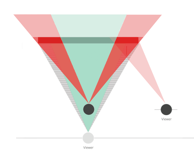

On a flat screen, the edges of the screen are always off axis by some amount. On OLED and VA screens, these off axis extents of the screen are non uniform color (OLED) or shift/shading (VA) gradients whose sizes grow the closer you sit to the screen.
The distortion field and eye fatigue zone is still there when at the optimal viewing angle (on a flat screen), but it is smaller. The edges of a screen are still as off-axis as if you were sitting an equivalent distance from them outside of the screen:
When you sit closer than 50 to 60 deg viewing angle, the sides are pushed more outside of your viewpoint causing a larger eye fatigue and non-uniform screen area on each side (as well as the PPD being driven down):
Almost always better off decoupling the screen from the desk entirely with larger screens, going with something like this to get a better viewing angle and higher pixel density:
Something like that or one with caster wheels . . or a wall mount, pole mount, separate surface, etc. and drop the desk back.

I was actually going to ask this… People keep saying micro LED won’t burn in, but aren’t ALL emissive displays at risk? Ironically enough, I’ve used my CRT’s a lot. And when kept calibrated and not over bright (90 or so nits in a light controlled room) I’ve never experienced burn in on them.
Inorganic LEDs can also loose their luminance but nowhere as much as OLED
Likewise CRT had this issue and "burn-in" is term from CRT tech.
That said none of my CRTs developed any visible burn-in. Phosphor is resilient enough for this to not affect even people who use these displays for decades. Its much more likely something else will fail than tube to develop burn-in.
I did saw quite a few burn-in CRTs and these include old B&W work/terminal tubes and tubes from arcade cabinets. I do not remember any color computer monitor with burn-in.
OLED unfortunately is nowhere near as resilient and burn-in happens much quicker even when used at the same brightness levels... and of course typically OLEDs are used with much higher luminance than what typical CRT could achieve.
