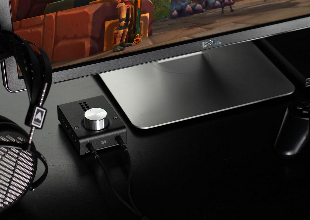

If you do though, I recommend checking out schiit's fulla, its a solid combo dac+amp for gaming that gives you high quality output for the price.
That said, your biggest upgrade is not going to be in a amp/dac, but a high quality headset, which the dac/amp would only be needed if it is analog not a usb headset.

I just took a look at this on their site, I might take the plunge and try it either way. $99 seems like a pretty good value for a dac/amp that also supports the mic. I was expecting at least double that price from Schiit, but that seems like a pretty solid deal.
I just took a look at this on their site, I might take the plunge and try it either way. $99 seems like a pretty good value for a dac/amp that also supports the mic. I was expecting at least double that price from Shiit, but that seems like a pretty solid deal.
I have the Schiit Fulla 3 for my laptop audio. It's a very capable little device that I'm using with a pair of Kanto YU4 speakers.
