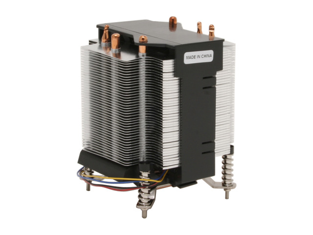

i might go pick this one up tonight,. :D Great reivews and $30 at my local store.
http://www.newegg.com/Product/Product.aspx?Item=N82E16835150082
i really dont want to remove my damn motherboard to install a cooler though :(
So i might just wait and order the ARCTIC COOLING Freezer 7 Pro because theres noway im removing my motherboard this install a cooler lol.
well i just picked up the new heatsink.. cost $32 out the door from tigerdirect.
Damn now its time to take apart my pc just for a heatsink *pulls hair out!!!*
