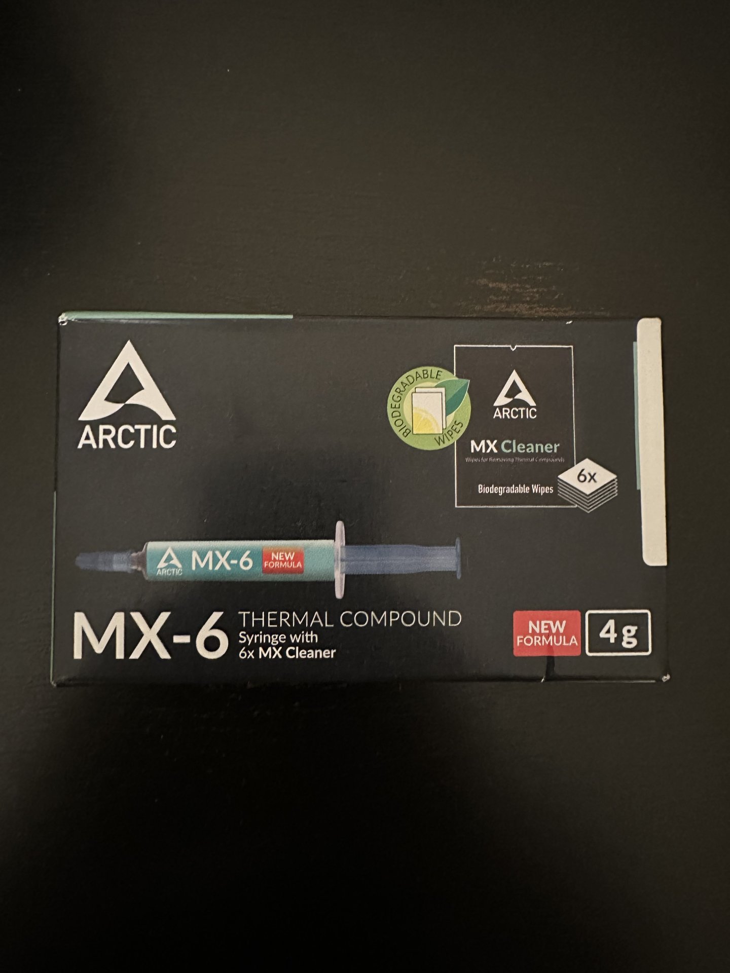

We got some Arctic MX-6. Any recommendations on how to apply the thermal paste? Small pea sized amount in the middle? Line down the middle? Or...?
return it and get 7. 6 has pumpout and seperation issues.
MX-7 shipped from outside our country and would take much longer to arrive. MX-6 was delivered the next day so we got that. We will probably be selling this PC soon anyway.

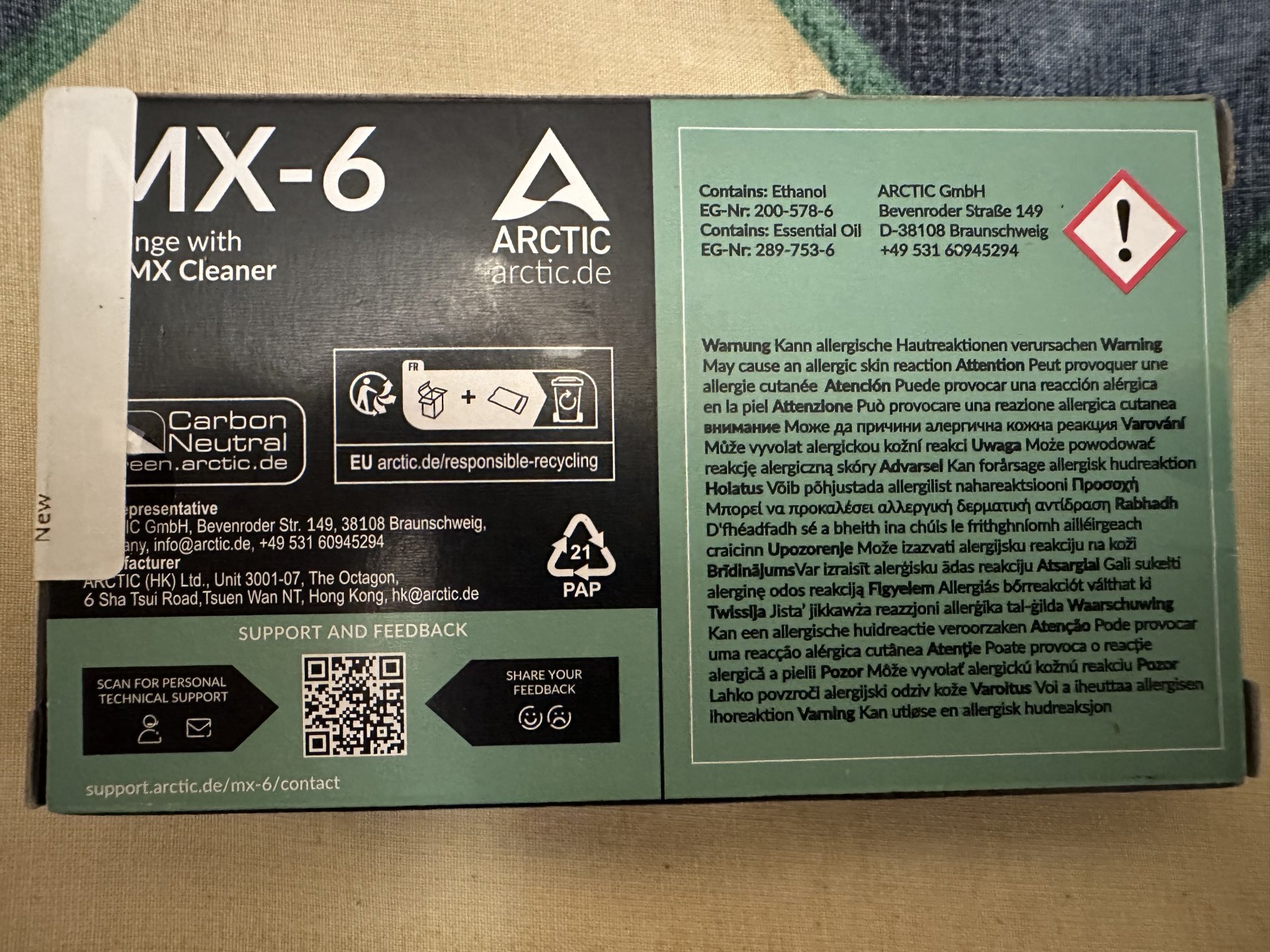

By the way, on the MX-6 we got, it says "new formula". Does that mean anything?
fuck ai. use their actual check tool. instructions should be on the back of the box.
