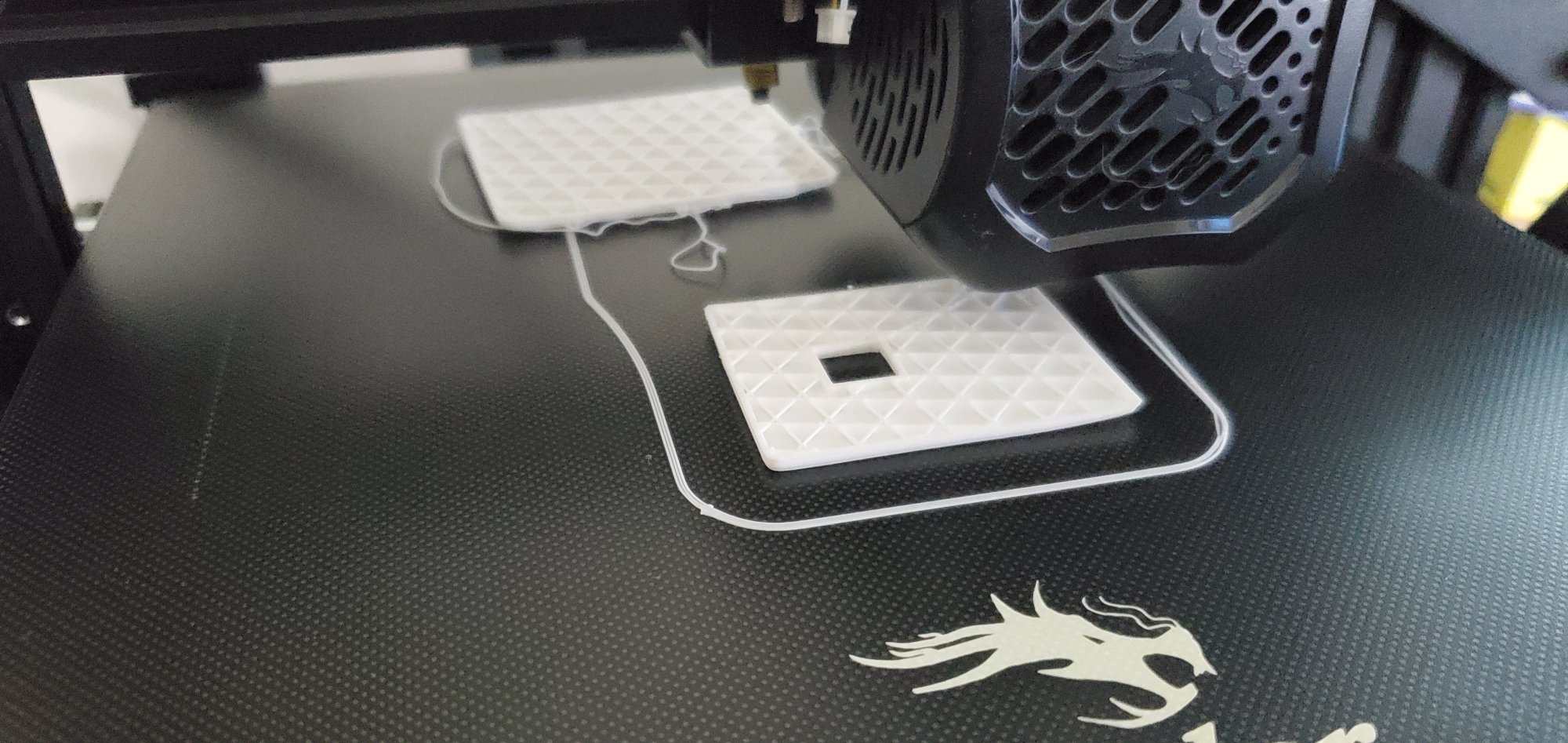

I have the Ender-3 V2 printer and as far as I can tell I have a level bed, however when I get about 20 minutes into a print, if I am lucky to get that far, whatever I am printing will no longer stick to the bed and start to move. I am using the inland PLA filament and the box tells me to have a print temp between 215 and 230 C and I have set it in the middle around 222. The system defaults to having the bed at 50 C and I have tried different temps between 50 to 60 C. I am getting frustrated enough that I want to chuck the unit but my wife would kill me if I did and I have hardly printed anything because I cant get anything to stick.
Thoughts?
I am trying the glue stick trick but I doubt that will even work.
I have a BL touch but never got it to work properly at all and when I set it up according to the directions, the tip was bent.

Here is a print I am trying. Look at the corners coming off. This happens a lot as well.
I have the nozzle set to 200 and the bed to 60 and it still does this. If I touch it, I know it will pop right off.
Did you try gluestick? It looks like its lifting all around so as someone else mentioned you might need to use gluestick or hairspray to help with adhesion. If the nozzle isn't moving enough filament that could also be an issue but it's hard to tell if that's what's happening from the photo.

Got with someone who does a lot of printing and we changed a bunch of settings. We made the bed run hotter at 65°C, nozzle at 220°C, initial layer at 0.28. he also said to use a raft. I had to take the kids to karate but this was the print shortly before I left.
I will see what it is like when I get home
And finished. The settings that were changed obviously worked and I will see if I can set it as some sort of default. It is a simple stand for my Galaxy Watch.
Nicely done! Also curious what you think made it work. Was the bed level or did it need to be tuned?
obviouslytom - which settings did you change, and to what?
I took a series of screen shots of all the settings. I will put them all up in the morning. The biggest one was changing the base to brim (I think) and having the initial layer at 0.28 and having it go slow, plate temp of 65° C and 220° C for the extruder.
From the help I got, mainly needed to be tuned. Since then, I have done some very minor leveling to the bed although I still get a little bit of spacing on the initial layer as you can see here when you zoom on and look at the left side compared to the middle. It's not affecting the print, but just annoying.
I would try moving it just a one quarter smidgen closer to the bed. And maybe try 3% decrease in flow rate.
