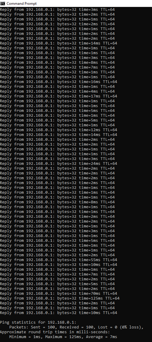

In another thread, a HO contributor said to poll my cards from the card to the router and see what I got. I polled the little USB 2.0 wifi adapter I am using, and got 1ms 96 out of 100 times, three 3ms, and one 4ms, no packets lost.
Then I polled the ASUS PCIe card and got this:
Every time I hear that bzzzzzt sound I get lag between the card and the router. No idea why. It almost seems like some conflict, but using Win 7 I never had this problem. Many people on the internet have said it is an ASUS/Microsoft problem, with most agreeing it i.sw a MS problem more than anything. Of course neither MS nor ASUS are going to spend any resources fixing it. I miss Win 7.
