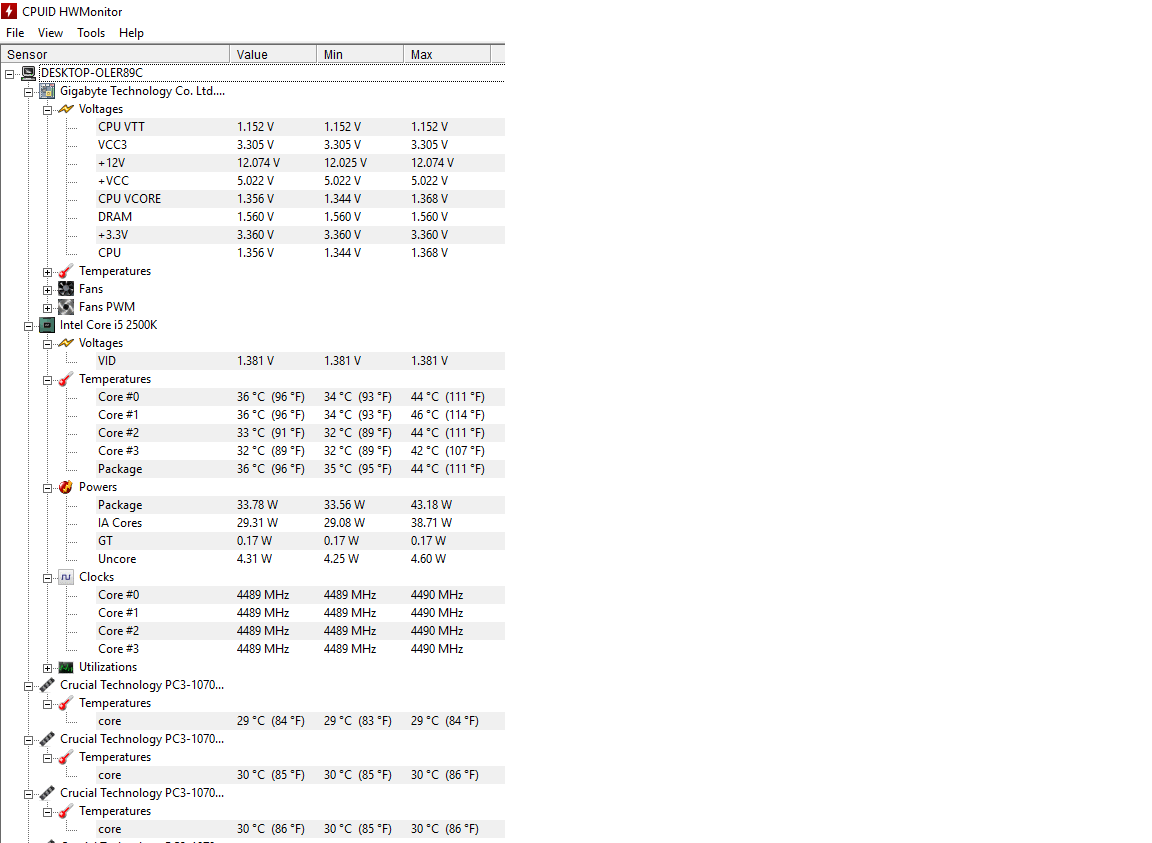

What do you have your VCore set at? Mine is 1.35v and steps up to 1.4-1.42 under a strong load. Also my RAM voltage is at 1.55v due to the fact my ram has LEDs on the heatsinks. My ram is running the XMP profile as well. So far when I dropped from 4.6Ghz to 4.5Ghz I haven't seen a lock up or BSOD while duplicating what happened when it crashed.

My voltage was similar but this isnt relevant. You need to tune your system independently.
I wouldnt go any higher on the voltage unless you have very good cooling.
I expect reducing the overclock to help because the voltage rise time doesnt need to be so fast at lower speed.
If you havent got any options to assist with voltage rise time for vcore then 4.5GHz may be your limit.
