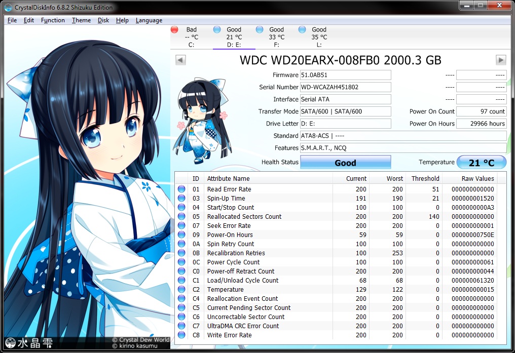

Here's what crystaldiskinfo has to say about the drive in question : diskdata.jpg

Wow almost 4 years of continuous use and the drive seems fine. Think it was a power spike causing some sector corruption of the FAT tables.. . It does happen quite often but we dont notice it. Once the corrupted sector is re-written the error gets fixed. It is when the head actually crashes and takes part of the magnetic media with it that it cant be fixed. My 160GB SATA1 Seagate makes a real high pitched banshee screeching sound once in a while.. Have no idea why.. Scares the hell out of me.. Happens in the middle of a copy as well.. I thought it was the head hittign the platters but its been working fine for over a decade so its not that.. I have noticed some drives slow down and then speed up again.. So many weird things going on. The 2TB seagate drive with over 33000 reallocated sectors still works, the copy speed dropped to like under 10mb at one point but then went back to 100mb.. And the weird thing is, it is one of the better faster seagate drives I have. Yea the worst of seagate is actually the best of seagates..
