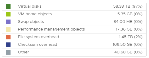

OP, does vsan report any "other" objects in your capacity usage? If so, those objects need to be manually deleted. I had the same issue where veeam got flipped around somehow and left a few TB of disassociated garbage in the datastore. Something to look at. Cleaning them out isnt too challenging and is a pretty good leaning exercise.
