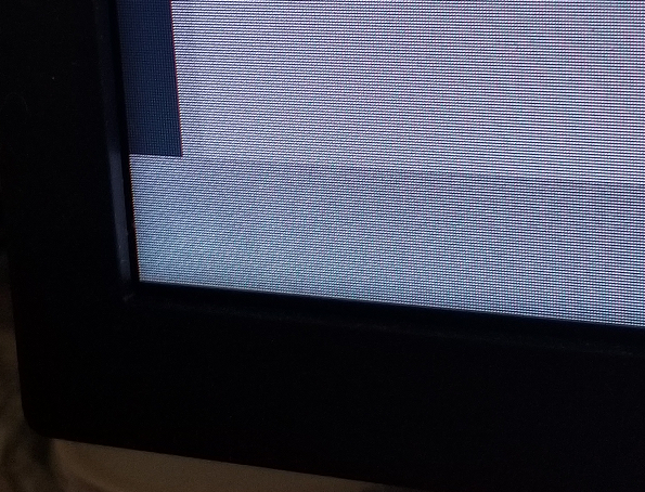

I've had my Samsung 32" C32HG70 for about 3 years now. When I recently upgraded my system from Windows 10 to Windows 11, I was pretty shocked when I could still faintly see the old Windows 10 Start-menu icon in the bottom left...
It's harder to see in the picture than when looking directly at the monitor, but it's clearly still there. I also provided a reference to what the button looks like (in case you aren't running Windows 10).

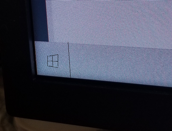

Yeah it's surprisingly difficult to get a good picture. It's probably more that the Camera in my Samsung S8+ is not great. In the 2nd image I mostly outlined the burn-in that I can see. It could be worse since you don't really notice it unless you're looking for it.

ah, i cant see the logo but i can see a slightly darker square now that youve pointed it out. start auto-hiding your taskbar i guess.
LCD image retention is usually not permanent. How long has it been running since you upgraded? I'd guess this should get better over about a day or so, but maybe a week. If not, just figure out how to move the button back ;)
