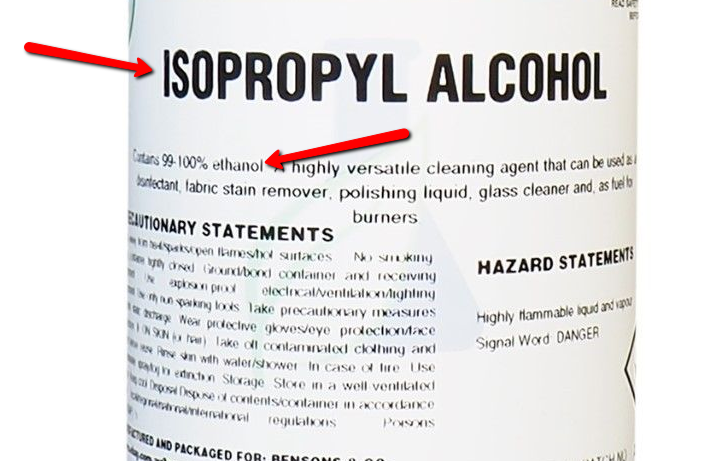

Using Ethanol To Remove Thermal Paste?
Yes, it's safe to use.
Ethyl alcohol consists of 2 carbon atoms while isopropyl alcohol has 3 carbon atoms. Ethyl alcohol is produced when ethene is hydrated or when sugar is fermented by yeast cells. ... Ethyl alcohol is suitable for drinking while isopropyl is toxic when ingested. Both perform the same as a cleaning agent.

Ethanol is fine. Used it to clean TIM many times. Rather surprised it would contain that. Especially higher than 95%/190 proof. ATF tends to keep track of such things.

That is an Au product, so no US ATF regulations. I think Ethanol is cheaper to make.. ISO HEET ( red bottle ) automotive antifreeze is 100% Isopropyl Alcohol, if you can't get 90% plus rubbing alcohol locally. I just use whatever store brand of 90%+ usually
it would fly under the radar I'm sure

Compare the smell to a high proof vodka. I'm guessing it actually is isopropyl and not ethanol. But yeah, either way, you're good.
