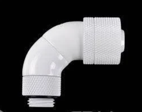

One more thing, I would avoid rotary fittings. I've seen brand new ones leak during a leak test. They would have caused a huge catastrophe if I didn't run a leak test.
It was one of these that rotate right at the split line in the middle. Avoid using these if possible.

You probably just had a dud. I've used rotary fittings quite a bit in my past 3-4 builds, no issues whatsoever. What brand were you using? I've pretty much just stuck with Barrow, been fantastic for me. 45, 90, and 180 degree rotarys, all good, never leaked.

It was a Bitspower rotary that leaked.
But they are so convenient. I'm willing to take the chance and run rotary fittings. I've had some Bitspower rotaries going on 10 years and they are still perfect. They look sweet as hell also. I know I can just connect multiple 45s which I do, but the rotaries look better and are easier to setup and use and I can hook around in hard to reach spots without using 90s which look worse imo.
In terms of used water cooling parts, a rotary joint is a part that I do not know how to service and I would avoid used rotaries.
I had several XSPC rotaries, 45s and 90s, leak on me. The rounded looking ones, I forget the specific part numbers/name other than they were the black nickel color. It was easily reproducible with all but a few. Contacted them about it and they said there were issues with the batch I happened to buy (verified by date). I had like 12 or 14 of them all told so no small issue (really big loop with tight bends). They offered to replace them but I declined, just didn't trust the design at all after all that. Went with EK for the rest of that build and had better luck but still had one come apart in the same way. Have a thread around here somewhere about it iirc.
I've found that if you use rotaries with press fit rotary joints, which is basically all of them (any brand)with soft tubing. It's best practice not to put added tension on the rotary portion if at all possible or the internal pressed seal may separate. Basically set them up, test them out and leave them.
I've used XSPC rotaries in a much smaller build since then and had no issues. So their bad batch claim checked out.
Wise choice. Unfortunately, there's no fixing them. Once they start loosening up and get easy to turn, or you can rock the rotary joint back and forth, they are on the way out (the pressed joint should stay super tight and hard to twist). If you ever notice the rotary joint showing any kind of gap no matter how tiny, be prepared to toss it. That's a sure sign that the pressed seal is going. I don't buy used rotaries either, altho I was given a bunch of Alphacool rotary compressions, they were scraped all up and looked raggedy but they were all solid as could be.

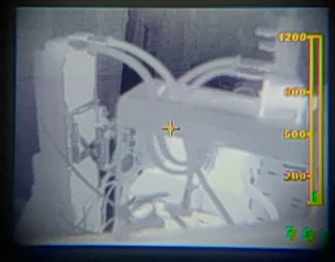

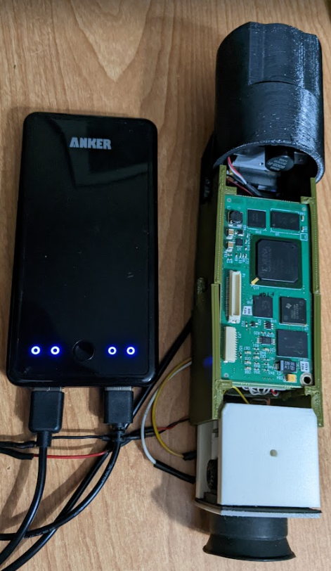

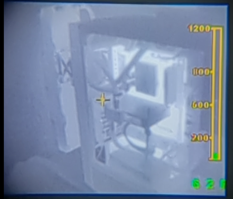

I am 3d printing my own thermal camera cases and water cooled PC's are real fun to view under thermal:

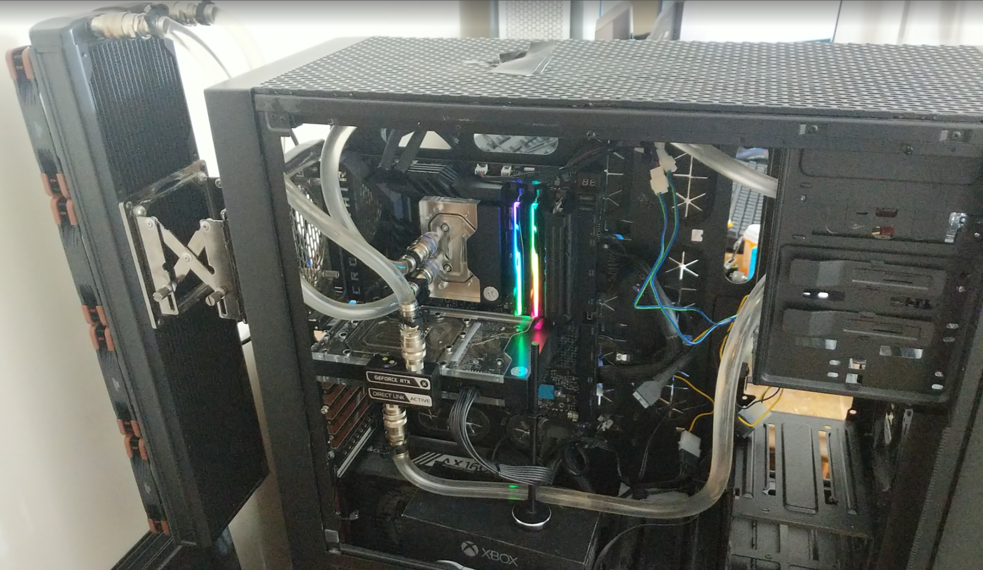

This is what I'm running on an AMD 5600X + 2080Ti. The radiator, CPU and GPU water blocks, dual swiftech MCP 35X2 pump are used watercooling from my friend's previous builds I did for him. The only new parts are tubing, and some Koolance quick disconnects. The male Koolance Quick Disconnects are always good for reuse, but its the female ends that get jammed up over time and I recommend getting brand new Female Koolance QD's.
View attachment 650668View attachment 650670
