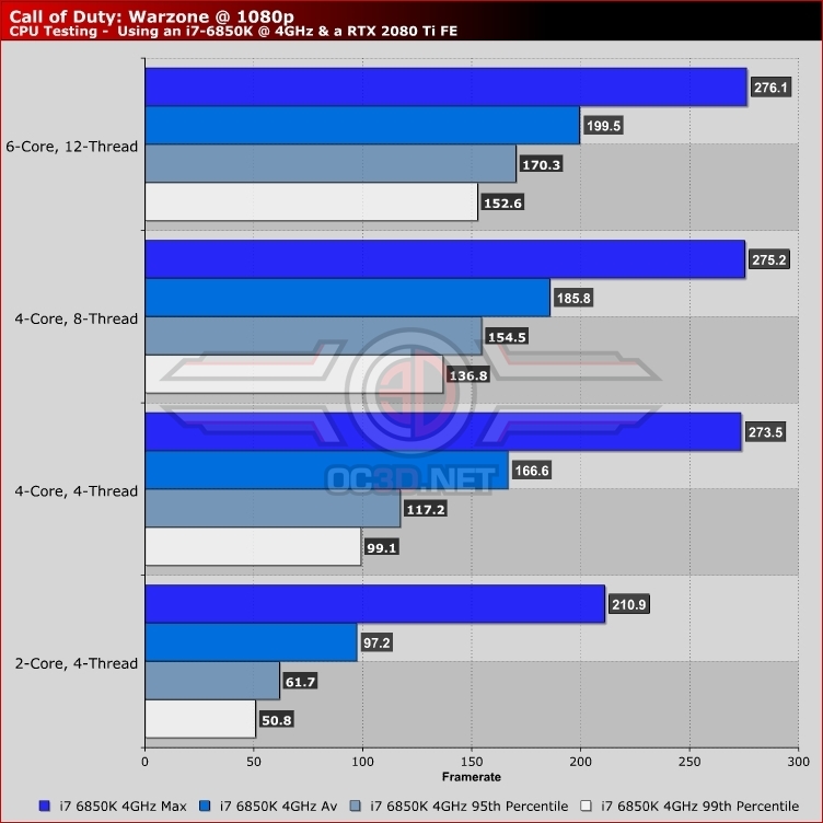

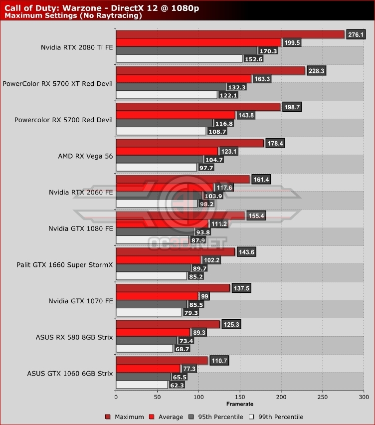

Assuming you're running overclocked CPU, You're likely GPU-limited in Warzone:

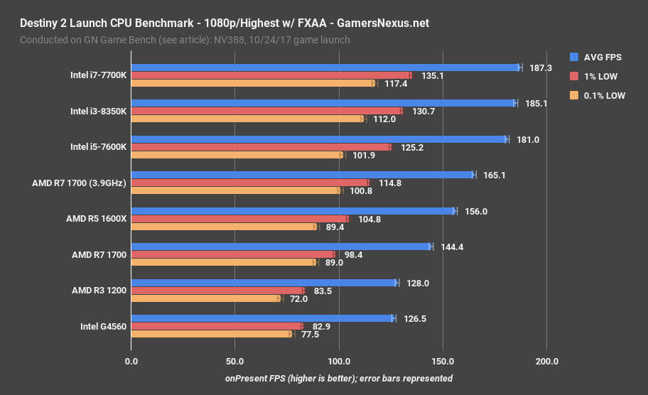

And Destiny will always be screwed on CPU, as it's not really scaling above 4 cores! But I think that even at stock speeds, your core i5 shoould be seeing 150 fps average fps/ 89 minimum!
I ran Destiny 2 on my 1060 6GB with 20% upscale, and I recall it falling below 60 fps pretty often. So you're definitely going to be seeign the fframerates you reporting on that GTX 980 Ti.
You need a new GPU today, and a new CPU within the next year.

Yeah, if you look around, nobody can top 144hz in this game - and given the fact that I can hit half that on my 1060 6GB, it's probably not GPU-limited.
If you want to verify what the limiting factor here is, try running your game at 720p. If your framerate doesn't increase by at-least 40%, then you're CPU-limited.

Yeah, you should be getting over 110 fps minimum in Warzone at those speeds, and Destiny 2 should be over 100 fps as well. IU just can't see anythgin else that could case your slowdowns (unless these benchmarks aren't accurate?)
Dropping to 720p will tell you for sure.

Yeah, 1440p widescreen is going to be a lot heavier on your 1070 equivivelent. You can verify by cutting your resolution down to 1080p, but It's time to upgrade your GPU.
