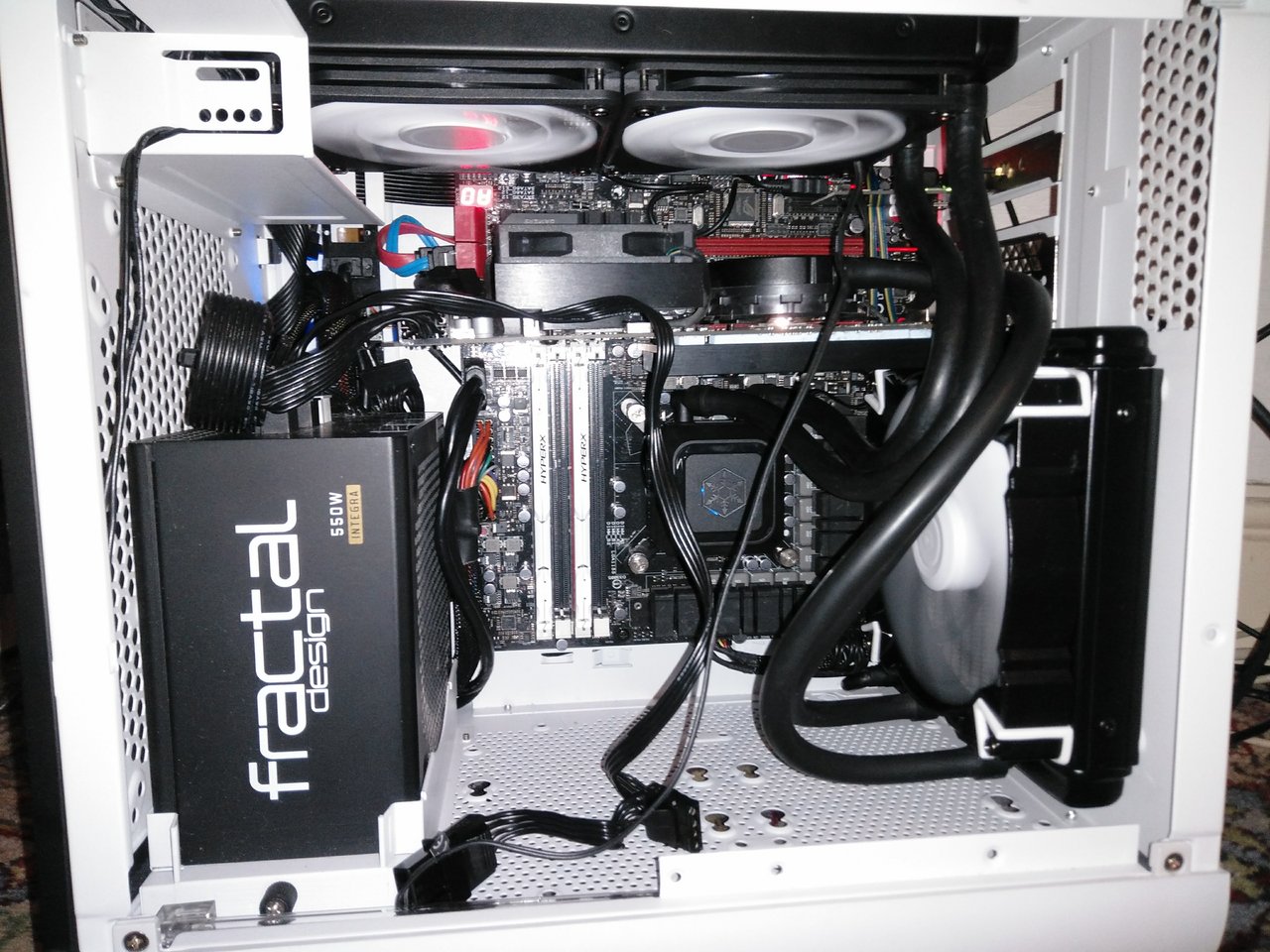

Temps really aren't an issue in this build (Ivy Bridge 3770s, 4.6Ghz @ 1.184v stable) - If I need more cooling I'll delid/relid it with some spare thermal grizzly Conductonaught).
The Gene V BIOS is a bit of a pain for fan speeds. I don't like the Q Fan stuff on it much. The other fan headers on it can't be set lower than 60% :(
I've got the two rad fans coming off the CPU Fan header via a splitter (max 40% speed, min 20% depending upon load - I like quiet!), The TD-02 pump is connected to the CPUAux header, it ignores the Q-Fan settings and just goes hell for leather, but with the 7v cable all it quiet with it @ 1500ish. My other AIO is for my GPU, it's an Arctic Cooling Hybrid III-140, The pump is annoyingly Molex powered so I'm going to take the spare hidden SATA connector behind the mobo where my ssd's are and plug in a SATA to Molex cable I have hanging around but wired for 7v).
Then I can remove the PSU Molex cable for a more tidy looking build (and do a bit more cable tiding while I'm at it too).

Why don't you just switch headers and use the 7v cable for the fans? Or alternatively get a fan controller for them and your other AIO.
Slick build by the way. :)
