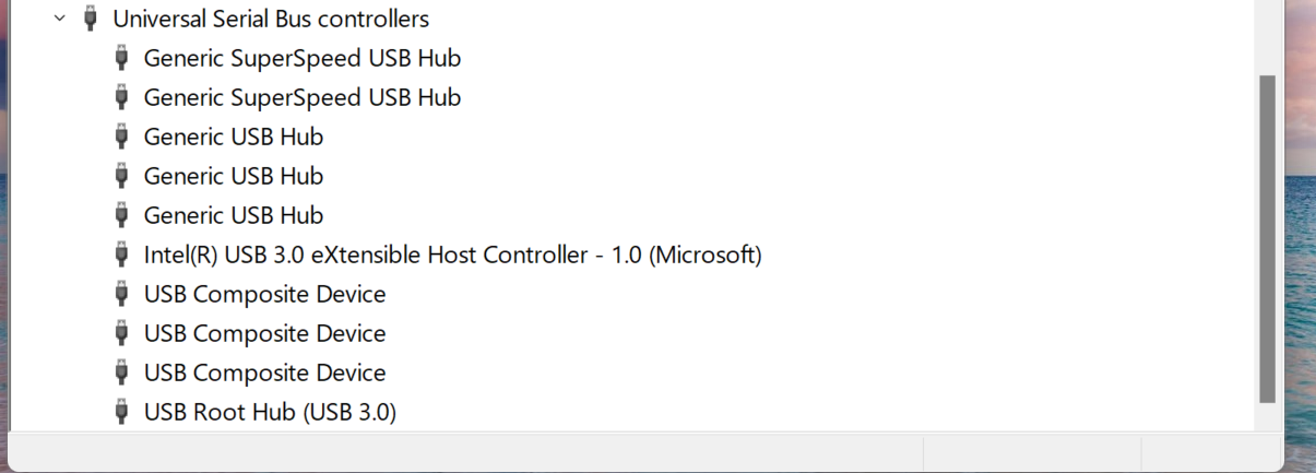

This is what my Device Manager USB items looks like.
When the problem happens, I'll get an additional item that says: Unknown USB Device (Port Reset Failed). My touchpad and pen will then not work and I can only navigate by keyboard. This is something very hard to do when so use to easier navigating inputs (even worse when most times the Tablet portion is disconnected from keyboard dock).
So this is what I've done so far:
Opened each USB item, selected driver. Rollback is greyed out an all items. No updates available for any of them. So I selected update, browse for drivers on your computer, Let me pick from a list of available drivers on my computer and under show compatible hardware, picked and installed the only option available. This reinstalled the drivers.

Next, for each of the USB devices listed that had power managment options available, I unchecked "Allow the computer to turn off this device to save power". Restarted computer again.
Now several times I've had the computer on and off, let it go to sleep, let it hibernate, shut it down completely, etc. and let it run (with and without running programs on it) for a good while and so far the problem hasn't happened again (knock on wood). I can't say for sure that it fixed it, but before it happened at least 1 out of 3 times the computer was on after a short while of running.
