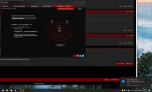

thanks, but it didn't fix it. so this sound blaster software has 2 settings, normal gain and high. when I turn on my pc the normal gain is selected, but the volume is low. if I click on normal gain it goes higher. I have to do this every time I start my pc or if I return it from sleep mode. I basically have to select the setting its already showing it on to actually set it. the volume level difference between "unactivated" and normal gain is probably 30%. this soundblaster goes no where near as high as the fiio, which I don't really understand. I can max the volume on normal gain and its probably as loud as I'd want to listen to. however on the fiio the volume level max I could listen to would be like 30%.

Unfortunate, could be many things, poor grounding somewhere inside your PC, dirty power, right up to defective card.
It most likely includes software and hardware to try and detect the resistance of the connected speakers and set the gain appropriately. It may be a bug in software or hardware that's making this not work right.

when I click the icon in my task bar next to the time to open sound blaster software. I get a windows notification and a diplicate icon shown here, then a couple seconds later one icon goes away.
