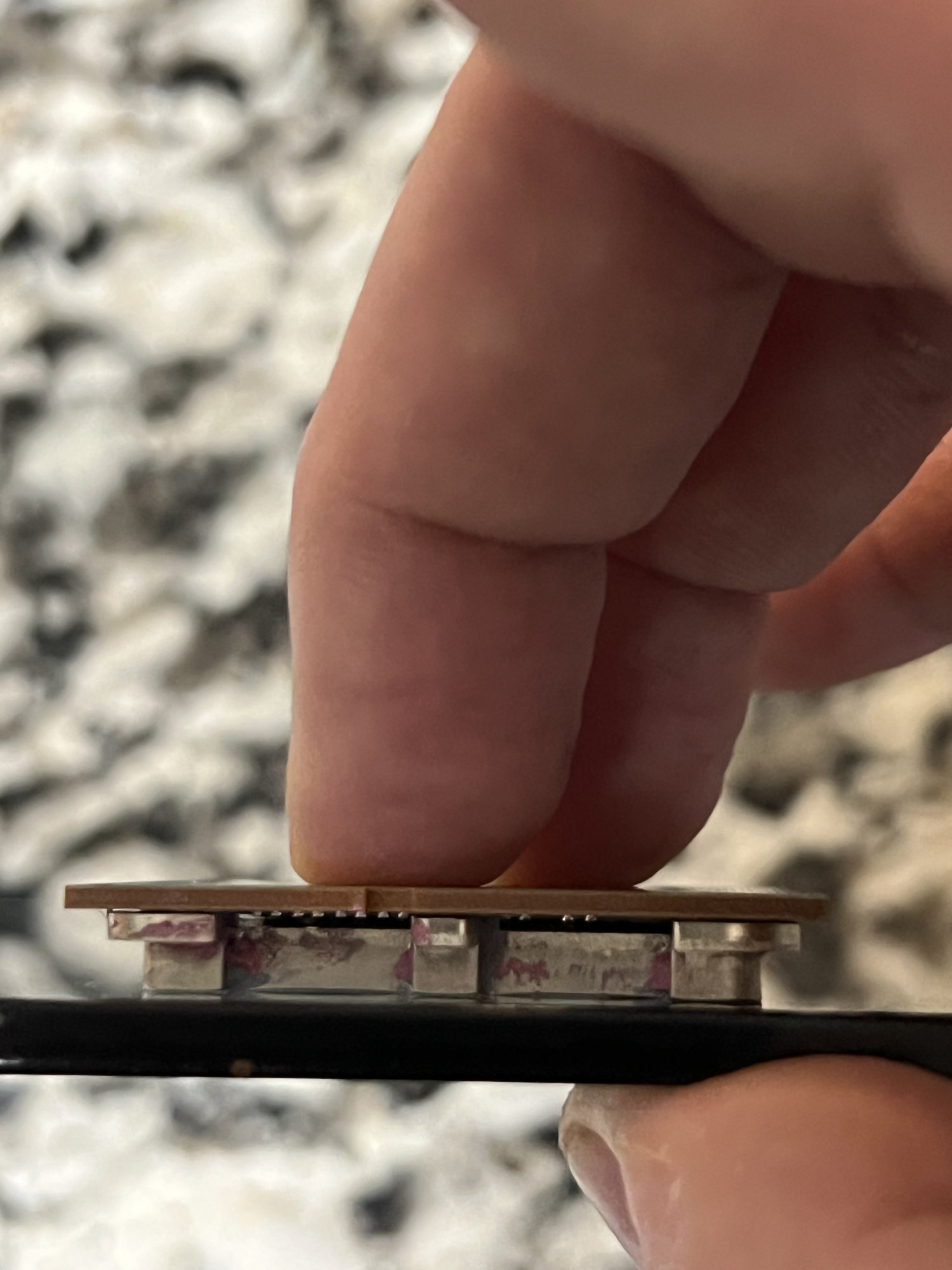

It isn't as clear in the images, but a lot of the IHS is bare and the bare spots match with the cold plate, so it was dry. I noticed that the IHS has gouged the cold plate. I know how to change a tire... I tightened the thumbscrews in a cross pattern while keeping tension balanced to prevent one corner having alot more pressure than the others.
The last picture shows my calipers being used as a straight edge you can see the gap at the top of the cold plate. I know these are machined convex. Not sure if that is too much. I didn't get a picture of it, but I checked the IHS with a credit card and it seems as flat as I can see with my eyeballs. No where near as extreme as the cold plate.
I wonder if the IHS being so thick is causing the cold plate to not be able to deform the IHS into being concave, causing extreme pressure in the center and pumping out all of the TIM.

Honestly all that looks fine including the curvature. Its kinda hard to tell how the tim is sitting as it kinda deforms and suck out of the tight spots when you pull the cooler off.

I don't think the ihs and heatsink are perfectly compatible as far as shape. Laping can be inconsistent as it doesn't take into account thermal deflection when cycling. I think a different perhaps less extreme tim is the solution for a decent, reliable thermal setup. Mx-4 is older but ive found its very robust and have ran it under pretty extreme thermal situations with success. If it works well for you I would just run that and leave 2c or so on the table.
Also probably won't be a issue but scoring on the mating surface could cause a problematic gap. Since its on the edge I would just continue mounting the heatsink in the same way and pressure you have been to attempt to keep it lined up with the chip edge.

At that point I would just lap the CPU and heatspreader. I dont think there is much of a reliable way to knock down exclusively that edge. And if there was that Ridge was mating with a elevated or pressure point of the current chip setup. May be better to just leave it and hope it mates in the same way that created the grove
I'd RMA/return it. Seems like they installed the heatspreader and glued it high on the corner. Can you lay the cpu flat to see if you see it raised on the bottom left?

Pretty sure I solved the problem. It did it again, so I lapped the bitch took about .3mm off. Dropped temps 5c in Firestrike.
Cinebench r23 still pegs out 95, but takes a few seconds to get there instead of instantly now. That is using my old MX-4 that was performing pretty meh before the lapping.

Wow, that makes me wonder wth is going on with the stock ihs. Glad you're closer to a solution I would be curious what the pattern of the mx4 looks pike when ya pull the block off and how much you can gain with a better paste
The notches are chamfered, but it looks like a channel runs in a bit. It was hard to capture with a camera.
I don't know if it came that way, or if the AIO caused it. I think that would be enough for it to pump out with the heat load of a 7950x.

Before lapping the MX-4 would idle in the 40s and sustain loads around 178watts. After lapping it idles at 38 and loads around 218watts. Wish I had a microcenter closer than an hour and a half away.
Aso need to lap the AIO a little better, I rushed that to make sure I didn't kill the chip. Need to measure how much cooler contact I still have. Maybe take a bit more off the cpu and see if I can get it off of 95c in all core loads.
